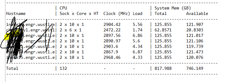

After I rerun the case, it also encounters problem of corrupted unsorted chunks and continuity can't converge well. I use 120 cores, OS system:
