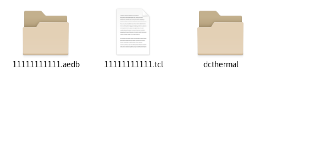

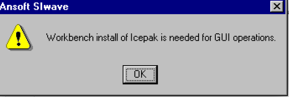

SubscriberThanks for your answer.The full message are shown below.When I try to exprot Icepak,an interface pops up as shown in the image below.The file type I exported is in .aedb format and cannot be imported into AEDT

Ansys EmployeeThanks for sharing the details. Which version are you using? .aedt is a format used by Ansys Electronics Desktop, not Ansys Workbench. Do you have Ansys Electronics Desktop installed? If not, please go to Ansys Download Center and use Ansys Automated Installer to install it. Thanks.
