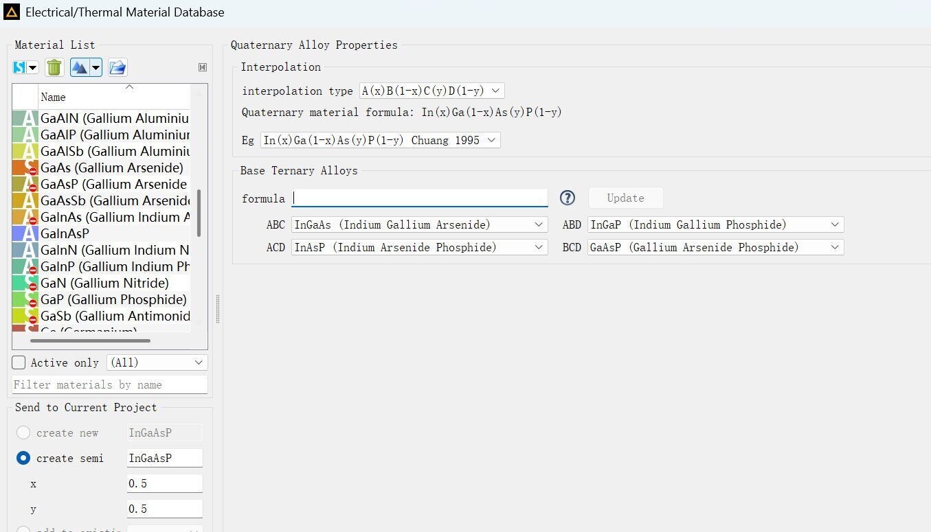

September 16, 2025 at 12:50 pm
1348335180
SubscriberI am a new user that use the lumerical charge. I plan to add a Quaternary Alloys InGaAsP to my object tree,and I find nearly all user manual,but I can‘t find the tutorial that teach me how to fill in the formula.I will very appreciate if you can teach me about my confusion or you can give some suggestion where I can find the anwser.Â
