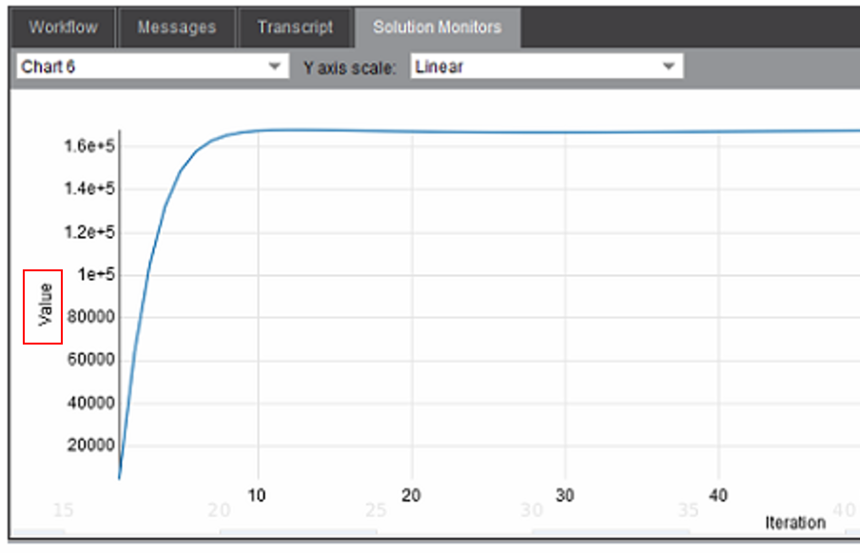

SubscriberHello, I wanted to add a chart with a calculated value to my solution monitors in order to better judge the convergence. In the Discovery AIM Documentation under “Examples of Calculated Value Monitors” all the created charts show the value over the iterations as seen below: 640 However, all the charts I try to create following the exact same steps as listed in the documentation show the convergence over the Iteration:
How do I change this? I'd like to see the calculated value instead of the convergence.

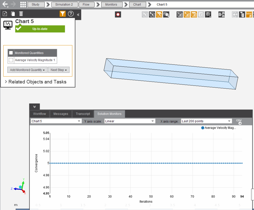

I quickly ran a simulation to check and clarify this issue.
I see that generating a chart from 'Monitors' for a calculated value, plots 'Convergence' vs 'Iterations' but essentially the Y-axis plots the Calculated Value only.
Below is an example to verify the same.

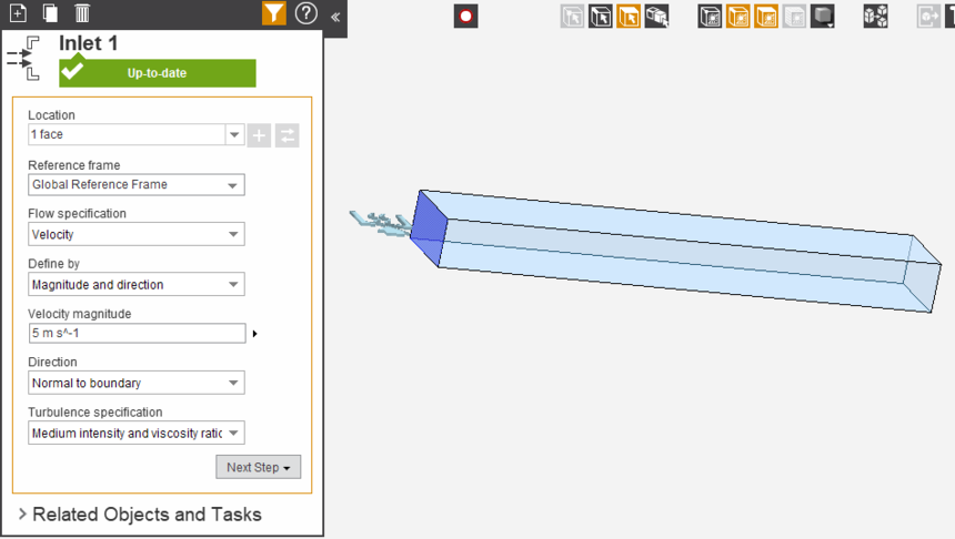

I gave an inlet velocity of 5 m/s to the geometry shown in the figure.
But when I generated a Calculated Value chart from 'Monitors', you will notice that the Y-axis shows the velocity magnitude indeed but 'Convergence' is written across it.
So this seems like an issue with the naming of the Y-axis.
I do understand this can be rather confusing. I will verify this with my team and see what can be done to correct it.

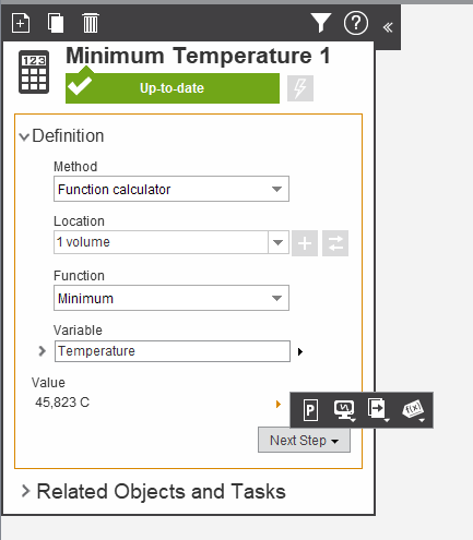

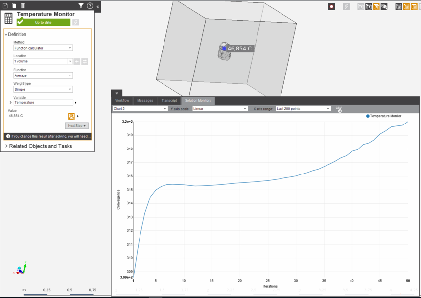

this doesn't seem to be the case for me. The calculated value which I'm monitoring during the solution shows a temperature of 46,854 °C as a result once the simulation is fisnished, while the values displayed on the Y-axis as the "convergence" range above 300.
My Simulation doesn't seem to converge at the moment (even when it runs more than 50 iterations), therefore it would be really useful to see, how the actual temperature changes with the iterations to better understand what the convergence is like.

Thank you for sharing the model.
If you run your mouse over the Result value, you will see the value in Kelvin and it comes to something over ~300K.
This is what is represented on the Y-axis of Chart 2.
You can also run your mouse over the curve o the chart and monitor the value at each iteration.
You will observe that the last iteration value matched the Result value in Kelvin units.
Hope this solution helps.
July 23, 2019 at 7:43 am
martina.mohr
SubscriberHi Subashni
I did not pay attention to the unit of the value. Thank you very much for your help!
