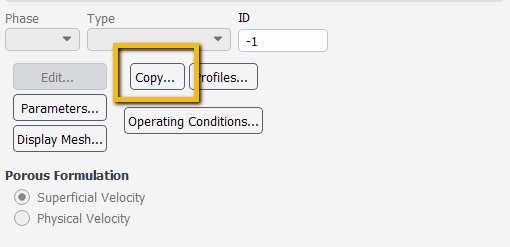

      Hello,nhow can I change the Material/Fluid with the Tui in an easy way? I have about 80 Cell Zones which are Air and they need to be Water.nIf i enter /define/boundary-conditions/fluid the Tui shows me zone id/name [Fluid_zone_79]. If I follow the questions the TUI asks me if I want to change the Fluid Air, where I can write Water.nSo for one Fluid it seems to work.nIf i enter a * and press Enter, I don't get the option to choose all materials. In the manual * stands for all, so what do I miss? At the beginning I changed them all by hand but that takes to long.nIs there an easier way?nRegardsnAndreasn

      Hello,nIf this is the only setting you need to change, you could use the 'Copy' option under Cell Zone Conditions. nnThank you.nKarthikn

      Perfect, thank you. nI didn't know this feature exist.nRegardsnAndreasn
