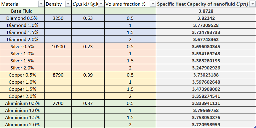

    • Ryan_Mitchell
      Hi Rob, nYep I always check the cell zone to make sure it updates once I have updated the materials. Below is a summary of my Specific heat capacities. I will double check my calculations on excel. Formula below.nnn
    • Ryan_Mitchell
      I have checked my results for the table above and they appear to be correct. n
    • Ryan_Mitchell
      Just to update this post I have increased the volume % of nanoparticles to 5% and acheived a 0.79 degree kelvin difference in temp with copper as the particle material. Using q = mcdelta t this leads to a 15% increase in heat transfer over that which is achieved by the pure Ethylene glycol fluid in the same pipe with a constant wall temperature applied. This is more in line with what I would expect. n
