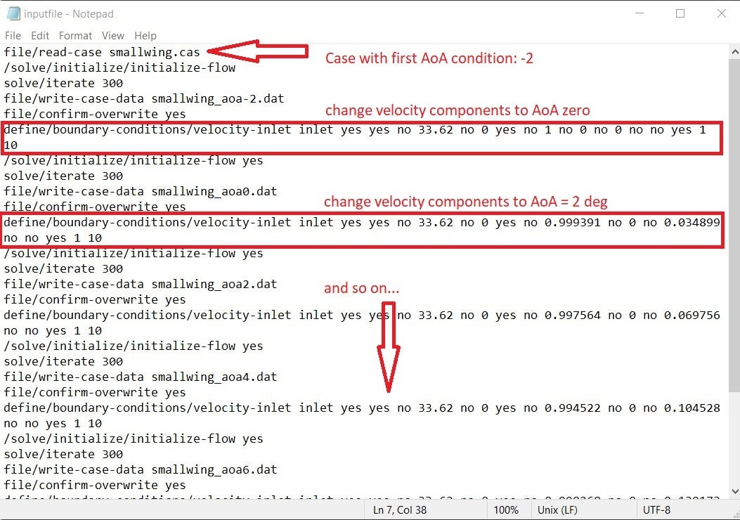

I am trying to run a batch job where I let the solution converge for some inlet velocity conditions and incrementally change the flow direction (by changing the velocity components). The goal is to get data for many angles of attack on a 3D aircraft wing.
I was able to set up the batch job and get data for different angles of attack by changing the flow direction manually in the GUI when creating the Fluent case, but that is time consuming for many studies. Currently, my Ansys input file is the following:
