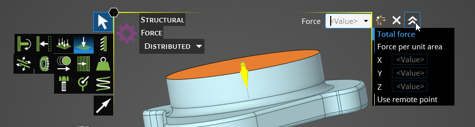

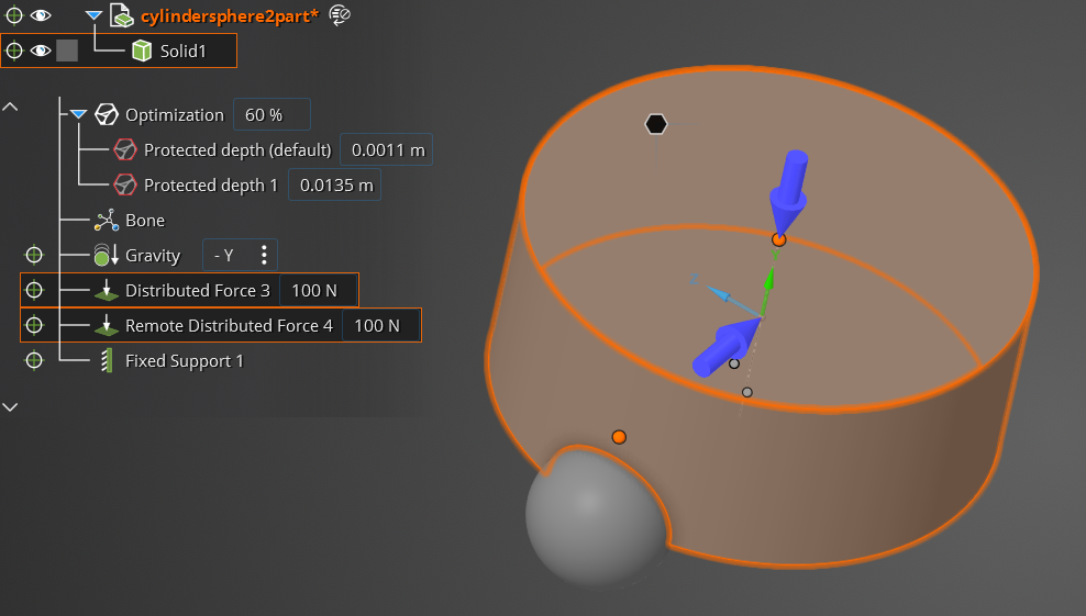

      Due to the shape of my model, I can only seem to apply forces in the Y and X direction. How can I input a force in the Z direction? So far, I only found the option to change the remote point of force application and not the direction. Attached is the model I used. Thanks for your help!

      You can input the components of the Force individually, from the HUD.
      Please click on the arrows in the HUD, as shown in below image, to reveal more options.

        Subashni I see. Thank you!
