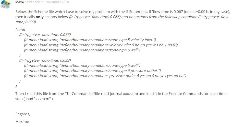

      I have a question on changing boundary conditions to be implemented in FLUENT. There are couple of options to achieve this action like using scheme file with UDF or dynmanic mesh events, etc.
      Currently, I need to change my boundary conditions i.e.,the definitions of Inlet and Outlet peridically since I am simulating a Transient FSI problem. I am suppose to change the boundary type of inlet for instance from pressure-inlet to wall and similarly, pressure-outlet to wall at specific period of time.
      I have seen couple of examples as well as queries posted on this community where, discussion about changing boundaries using scheme file happened.
      /forum/forums/topic/read-scheme-file/
      As mentioned by Max4 in the above link, where he has written a similar scheme file to change the boundary conditions.
      Could anyone tell me what does the syntax in red box mean ? I'm not able to understand "6 yes no 0 no yes yes no no". I have seen such kind of syntax commands in other codes written. I'm trying hard to find the meaning of the syntax and I could rarely find any proper fluent scheme language documentation.
      As mentioned in the link by max4, that this scheme file has to be read and loaded in the execute commands. So could anyone tell me how to load such a scheme file in Execute commands ?

      I wont debug what you posted. But you need to define the to variable first. That can be done once . The rst of the scheme commands should be executed every time step or iteration as calculation activity where you read that journal. NB: scheme procedure ( i guess what you want to achieve) requires an input. keep it simple and do it as Max did.
    • vani
      I get what you are saying. I defined the variable fr, cond in Fluent TUI using "rp-var-define".
      even if I follow what Max did, I am still unaware as how to load that scheme file in the Execute commands.
      This is what max has written. How does one load this file in Execute commands.
      Best regards
      If you look in the Calculation Activities there's an Execute Commands option. In there you can type in TUI commands, and activate these every some timesteps or iterations.

      You need to read the scheme file as journal under calculation activities and execute it every iteration or time step.
