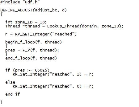

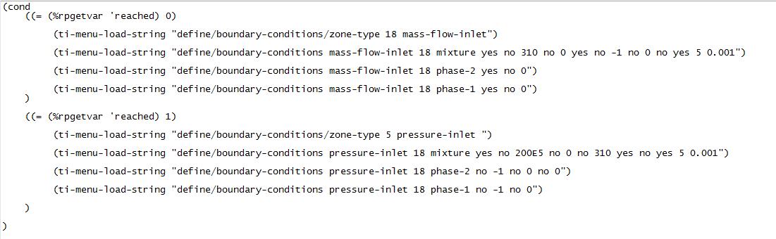

      I have wrote the following UDF and Scheme.
      1. I have define a RP variable named "reached" which defines when the pressure at the outlet is reached: Where do I hook this Scheme?
      2. I have write a UDF to access the pressure on the face and change the value of the RP variable by using RP_Set_Integer("..") if the criterion is reached. Where do I hook this UDF?
      3. I wrote a Scheme in order to change the BC according to the value of the RP variable (1 or 0). This Scheme will be load in the Calculations Activities.
      Is the method the right one and the functions correct from your point of view?
      Maxime
    • DrAmine
      Max: This is an open communtiy and i think I need to remind you that we from ANSYS do not debug or comment on any UDF or Schemes. If we are provindin hints than this is pure goodwill.
      1/You can add it into you .fluent file (on Windows platform under C:Usersyourname)
      2/Function Hooks: Check the Manual for that
      3/I won't comment on the commands but the workflow seems consistent

      Ok thank you. Last question about the RP_Get_*. Is the using of the "RP_Set_Integer("...") = r" in the if_loop correct?
      Maxime
      Add some comments into the UDF and see what's reported on the screen: it's the best way to test logic loops.
    • DrAmine
      Now it is wrong.
      RP_Get_Integer (No capital letters)
      RP_Set_Integer is correct but the " = r" is wrong. And now start debugging as highlighted by my colleague

      With RP_Set_Integer("..") I change the value of the integer. But how should I then affect the change of the variable into the Scheme?
    • DrAmine
      It set the rp value from C-Side. The changes are committed as soon as you iterate and you are using the % thing.
    • Max4
      So I have just to write: RP_Set_Integer("reached", 0) to directly affect the value from C-Side?  In the Scheme I use the %rpgetvar.. so it may be ok.
      Is it then mandatory to write "RP_Get_Integer ("reached")" at the beginning of the UDF or it's useless.
    • DrAmine
      You need to decide that..
      I will recommend checking the existence of a rp-variable in C-Side: Again check the documentation for that.

      The values are changed and assigned during the simulation. By check the existence of the variable, do you mean the " r " if I use " r = RP_Get_Integer("..")"?
      In my UDF, can I just write "RP_Get_Integer("..")" so that the if loop can affect the change on this variable if the condition is met?
      Maxime
    • DrAmine
      I mean what is documented in the Customization manual Chapter 3.6
