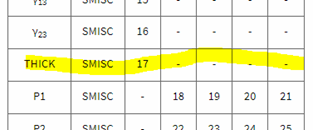

Ansys EmployeeIf this is a surface body meshed with SHELL181 elements, it is possible to postprocess the new thickness.Refer to Table 181.2 of the Elements Manual for SHELL181. You will find ÔÇÿTHICKÔÇÖ listed as a summable miscellaneous results item (SMISC=17) in this table.

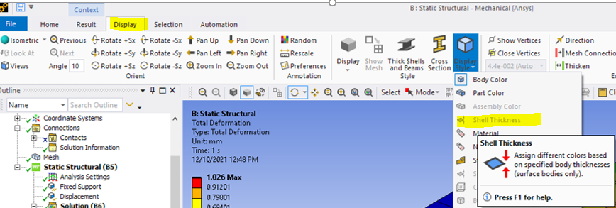

Be sure to set General Miscellaneous results to ÔÇÿYesÔÇÖ under Analysis Settings=>Output ControlsÔǪ before running the analysis

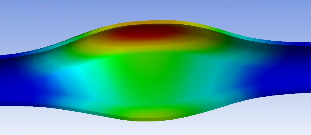

I added a command "et,matid,SHELL181" to convert element type. I also meshed surface body with linear element type. I then followed your guideline.
However the result of direction deformation shows that the shell thick is still uniform
(This is only partial result because the simulation was not fully converged)

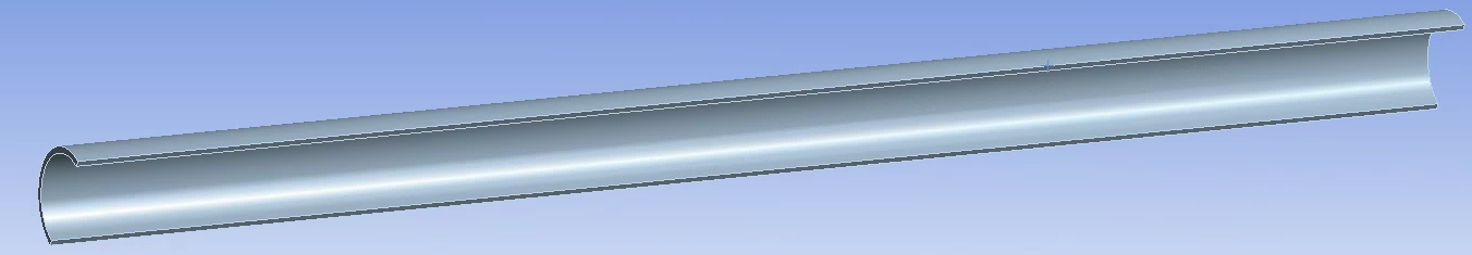

Ansys EmployeeIs this a surface body or a solid body.
Sorry for the confusion, but this needs to be a surface body to be meshed successfully with shell181 elements. It cannot be a solid body.
Also, I am not sure you will "see" the change in thickness, just a contour plot in the shell181 elements illustrating the distribution of the change.

SubscriberYes , it is surface body. There is only one cylinder surface.
