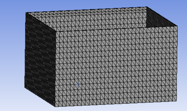

Subscriberthanks for your reply.nFor the Mesh on the water tank, Shell elements are not used. n

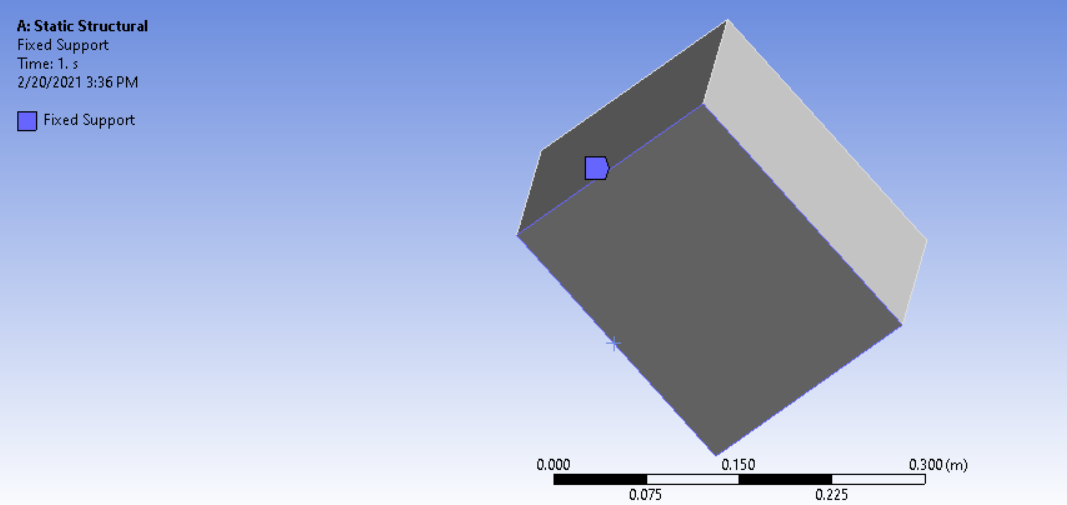

Force is applied on the one fave of the tankn
Fixed support is given in the lower edges of the drumn

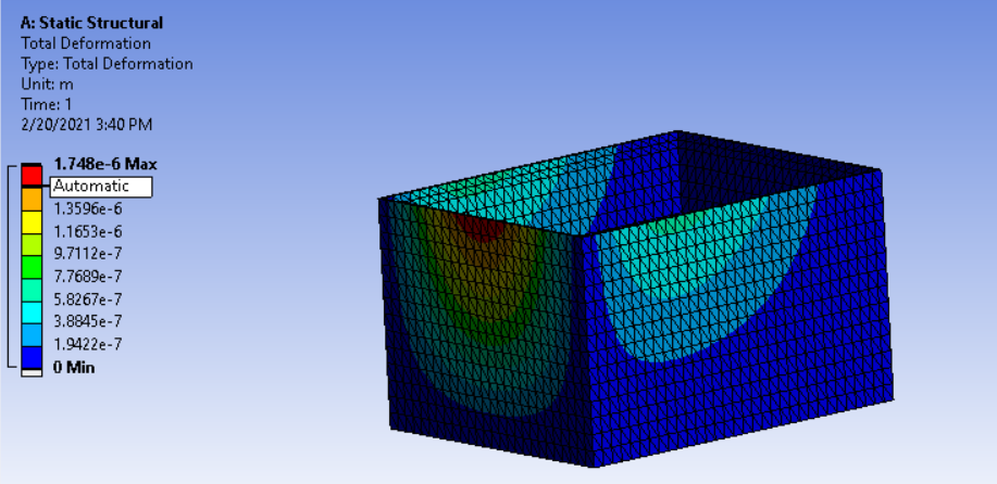

I changed the Force from 1N to 100N on the face. I didn't see much change in the eigenvalue.nTotal Deformation for 1N forcen

SubscribernErik's example is very good to learn from.nFor your model, you should definitely replace the solid body with a surface body and get shell elements.nWhich mode vibrates that surface? You should see that mode move when you have significant force, but you don't have a rigid structure so you can't build up much tension in the shell elements from that force.nnFebruary 20, 2021 at 5:11 pmkashfia.mahin

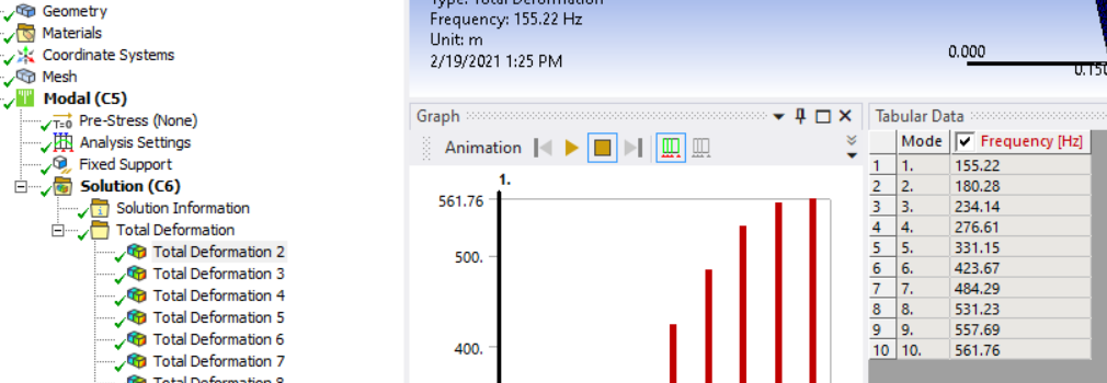

SubscriberThanks nI have tried first the way Mr. Erik said. For the free boundary condition of that tank, the frequencies are very smaller than when I applied the support on the edges. nBut when I applied the force on the outer face, it doesn't change much in the eigenfrequency. n
the above picture is the 1st Mode of Deformation of the tank while considering only the Modal analysis.n
The 2nd picture is the 1st mode of deformation of the tank after Static Analysis.nAs I am a new learner in structural dynamics, sometimes I miss the parameters to consider. n
