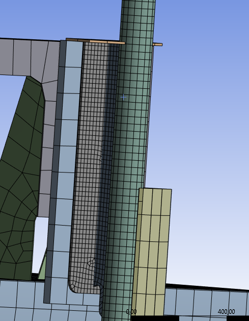

      I'm new to Ansys and I'm not able to solve the following problem:

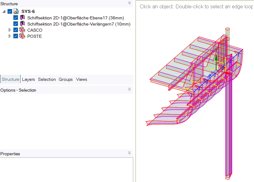

      I have an assembly which consists only of surface elements.
      When I generate the mesh I receive the following alerts:
      Info: "In one or more contact regions, the contact area or the target area of shells is set to program-controlled. This can affect performance when writing the input file. Consider displaying element normals and selecting either the top or bottom shell area. "
      Warning: "The contact status has suddenly changed.  Check the results carefully for possible separation of contact areas."
      Nevertheless, up to here I can calculate a solution.

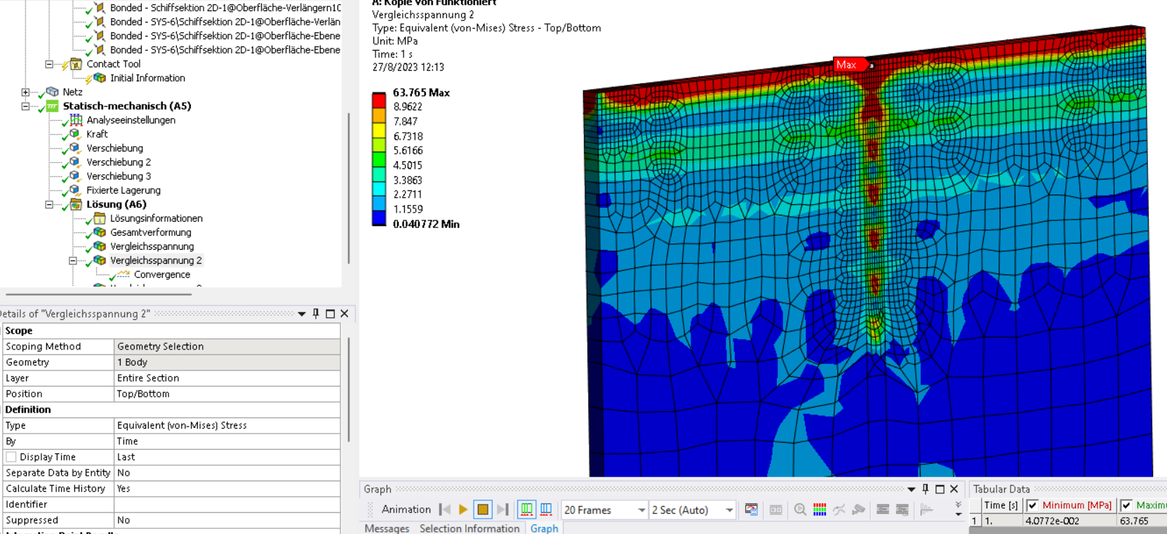

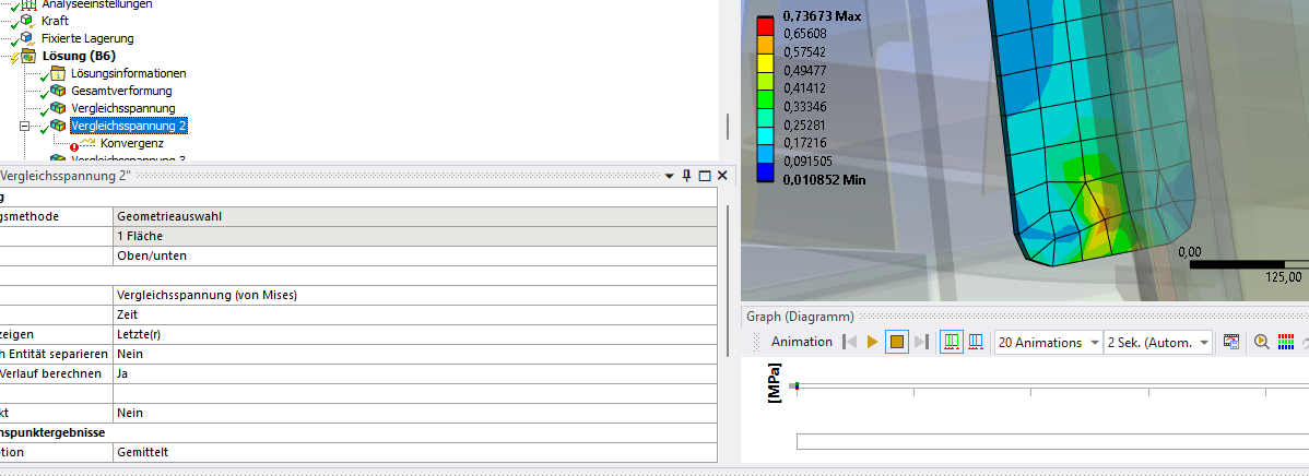

      The problem starts, when I add a convergence for one surface. The program does not calculate further and gives me the following allerts:
      Error: "A contact assignment does not contain any elements. Right-click on the message and "Go to Object" shows the contact area.
      The assignment may have been removed by meshing or the trim tolerance is too aggressive."
      Error: "An error occurred in the post-processing module: invalid or missing result file."
      Error: "An error has occurred in the Solver module: general error."

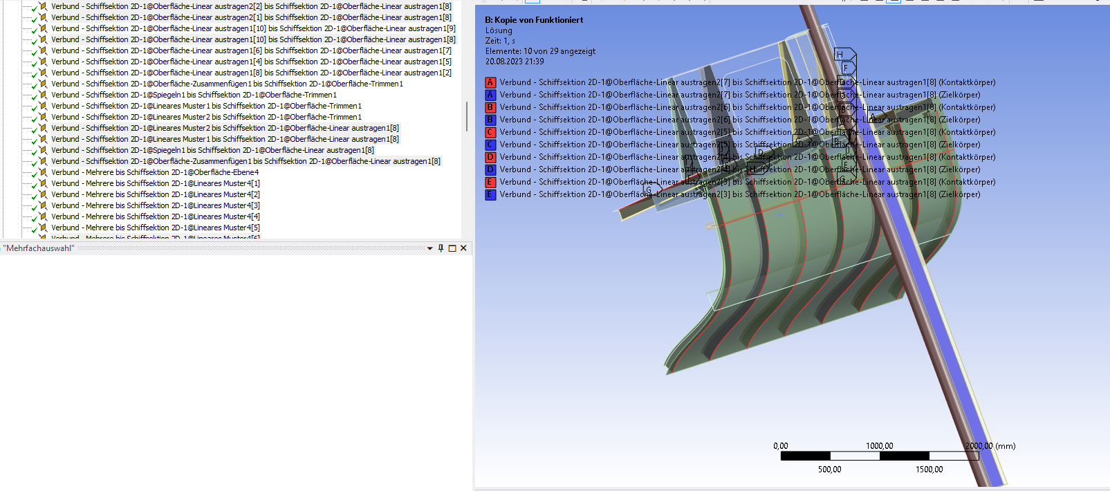

      it takes me to this view when i right-click on the last error message. 25 of my contacts are marked here, but I dont know how I can resolve the problem.
      Thanks a lot for any help in advance :)

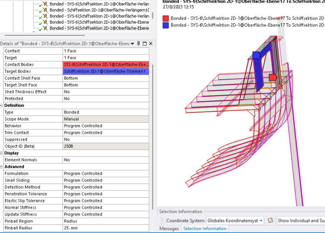

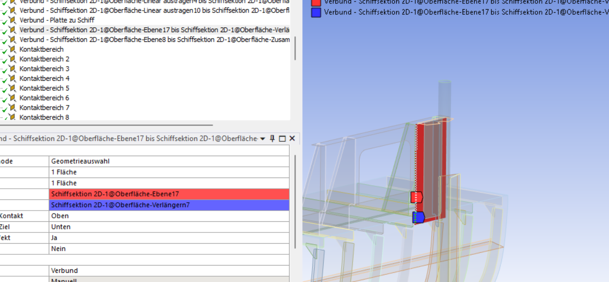

      I did some more work on the topic and found 3 connections in the contact tool, which are marked in orange.
      NameKontaktseiteTypStatusAnzahl der KontaktelementeDurchdringungSpaltGeometrische DurchdringungGeometrischer SpaltPinball im ErgebnisReal-Konstante
      Verbund - Platte zu SchiffKontaktVerbundGeschlossen351,42E-14002136131
      Verbund - Schiffsektion 2D-1@Oberfläche-Ebene17 bis Schiffsektion 2D-1@Oberfläche-Verlängern7ZielVerbundGeschlossen8131,42E-14002310134
      Verbund - Schiffsektion 2D-1@Oberfläche-Ebene8 bis Schiffsektion 2D-1@Oberfläche-Zusammenfügen4KontaktVerbundGeschlossen51,30E-050021,08536135

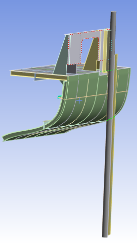

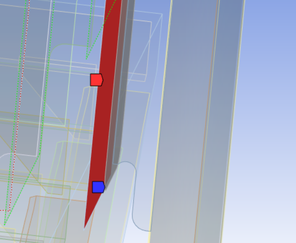

      These Contacts all belong to parallel planar surfaces, that are connected to each other. The next pictures shows one example:
      Im not sure if that is the reason why I cant apply convergence to my surfaces.
      Kind regards
      Tim

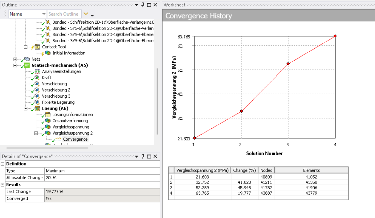

      Hi, I was able to perform a convergence on the surface you requested. I had to make many changes in the geometry using SpaceClaim. I removed all the contacts you had created and used the option of shared topology by creating 4 separate parts.
      1. Hull
      2. Column.
      3. Parallel Surface 1.
      4. Parallel Surface 2.
      I created bonded contacts between these 4 parts. On the parallel surfaces, I placed a pinball radius between the surfaces
      With the analysis resolved, I added convergence on the surface of interest.
