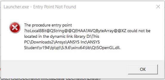

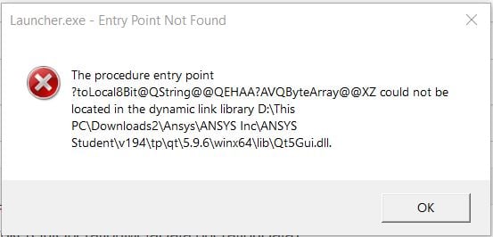

      I am currently using Ansys 2019 R2 and when I create a Fluid Flow (CFX) and try to enter setup I get this error.
      System.ApplicationException: Application failed to connect.
         at Ansys.CFX.Foundation.App.CUEApplicationProxy.Start(Boolean waitForCommands)
         at Ansys.CFX.CFXCore.App.CFXPreProxy.LoadApplication()
         at Ansys.CFX.Foundation.Data.CUESourceDataObject.Edit(IFullContext context, Boolean interactive)
         at Ansys.Core.Commands.Concurrency.CommandWorkUnit.executeInContext(CommandContext subContext, IExecutionEngineCallback tracer)
         at Ansys.Core.Commands.Concurrency.BaseWorkUnit.doExecute(IExecutionEngineCallback executionEngine, CommandContext subContext)
         at Ansys.Core.Commands.Concurrency.BaseWorkUnit.Execute(IExecutionEngineCallback executionEngine, Boolean dontCatchExceptions)
      --- Ansys.Core.Commands.CommandFailedException: Application failed to connect.
      CommandName: CFX.EditSetup(Container="Setup")
         at Ansys.Core.Commands.CommandAsyncResult.RethrowFailureException(Exception e)
         at Ansys.Core.Commands.CommandAsyncResult.Wait(Int32 milliSecondsTimeout, Boolean exitContext)
         at Ansys.CFX.CFXCore.Commands.EditSetupCommand.InvokeAndWait(IProtectedContext context, DataContainerReference Container, Boolean Interactive)
         at Ansys.CFX.CFXCore.Commands.EditSetupGui.Invoke(GuiOperationContext context)
         at Ansys.UI.GuiOperationContext.Invoke(GuiOperationMetaData operationData)
         at Ansys.UI.UIManager.InvokeOperationCore(String pseudoname, OperationDelegate callback, Boolean allowOSMessages, Boolean coreTransaction, Boolean deferredRefreshOnly)

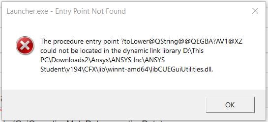

      I've tried reinstalling Ansys but still get the same results. Then when I try to open CFX by itself I get an error saying Launcher.exe - Entry Point Not Found and that these files could not be located but when I check those locations the files are installed.
    • tsiriaks
      Can you try installing 2020 R1 with default location (C:Program FilesANSYS IncANSYS Student) ?
    • Jhwww
      I reinstalled it to the default location but I still get the same errors
    • tsiriaks
      What if you rename C:Users.cfx   folder to anything else, then try CFX again
    • Jhwww
      I looked in that location but I don't have a file with that name. Is this a file that I should have?
    • tsiriaks
      It's a folder. You should have one. But maybe it's hidden ? Make sure you set your Windows to see hidden files/folders.
    • Jhwww
      I looked in"C:Users" but I don't see a folder named .cfx. I also tried looking for it in the search bar but the the only things I find are the folders in "C:Program FilesANSYS IncANSYS Studentv194"

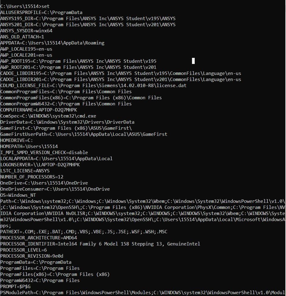

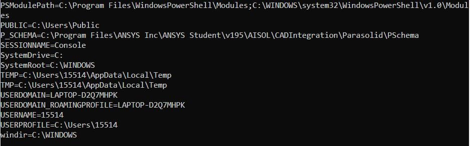

    • tsiriaks
      open up CMD Prompt, then enter the following command
      set
      and post the output of it here

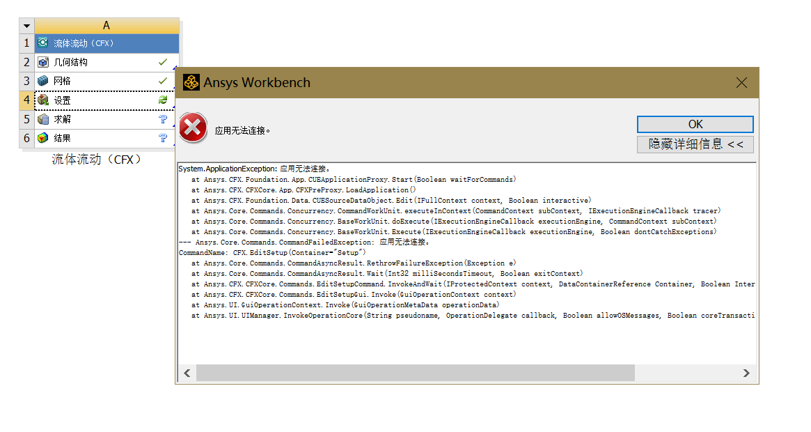

    • x399liu
      I met the same problem, and I cannot find .cfx in "C:Users". Here is the output of "set":
    • x399liu

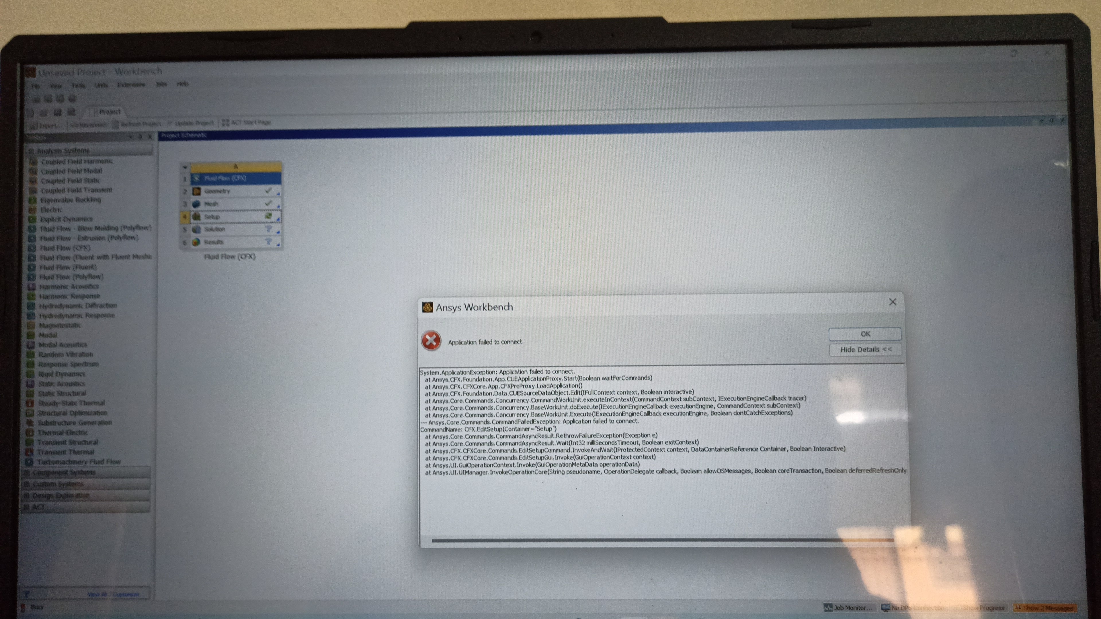

    • x399liu
      By the way, I use the student version 2019 R3 or 2020 R1. But in the version 19 on our school cumputer, I can find the .cfx folder.
