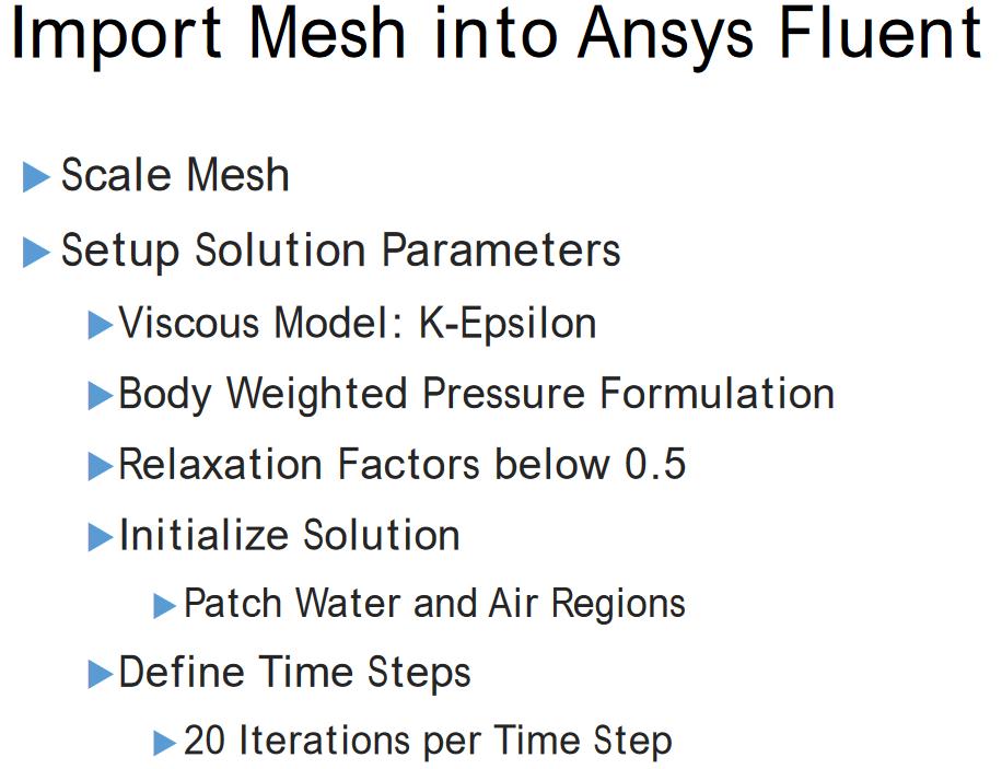

      Unfortunately there are not a lot of tutorials available for flow around ships. The closest I could find is the symposium presentation in which they use Ansys Fluent:
      Using Computational Fluid Dynamics to Predict Drag on a Boat Hull
      A few pages from the presentation:
