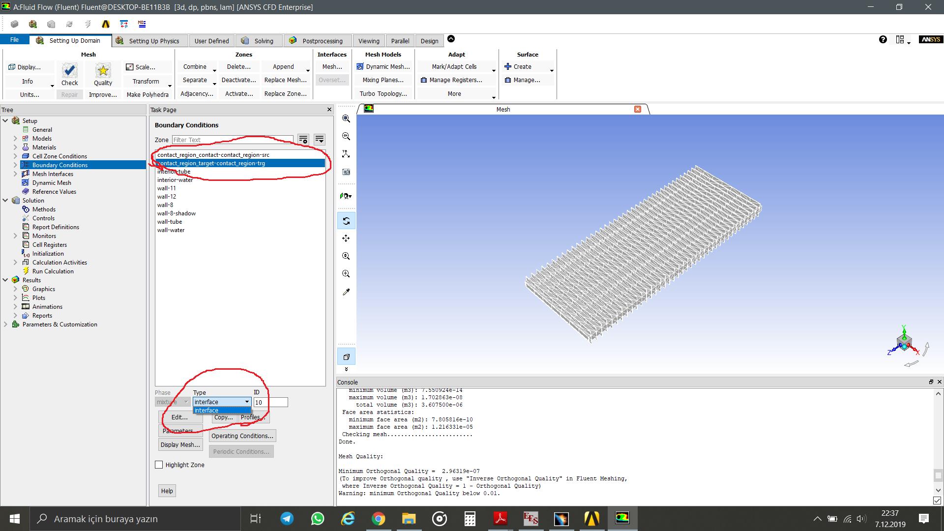

i am a student of automotive eng. and i want to make a heat transfer and exchange analysis with cfd fluent but i cant assign wall boundary to the contact regions so the heat transfer is 0. how can i fix this situation? and is there another method to make radiator analysis?

Forum ModeratorIf you create a conformal mesh it'll help. But you may also need to make the radiator bit solid. As you've not really explained what you're trying to show it's not easy to answer.Â
