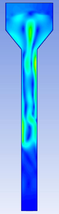

      Hello all,
      had simulated the transient 2D airlift bioreactor, when the simulation was done. the CFD post graphic was appear like what I expected but after I used the time step selector or video rendering,I cannot find the first appear CFD post graphic, I tried to look in time step selector in every single time step but not have any graphic that same as the first appear CFD post graphic, even in the video.
    • Jamessmp23
      1. How to find the first appear CFD post graphic ?
      2.
      From these pictures does this simulation has the circulating at steady state, which one is correct result from the simulation ?
      Thank you,
      James

      Here is the picture comparing the first appear CFD post graphic and the graphic at the end of the video.
      3. Does this simulation calculate as the cylindrical structure or as the rectangle structure ?
    • DrAmine
      Does the right picture corresponds to the first time step?
    • Jamessmp23
      Hello Amine,
      The right picture corresponds to the final time step.
      Any suggestion ?
      Thanks for replying,
      James

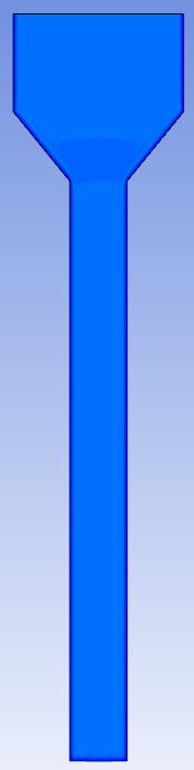

    • Jamessmp23
      I getting confuse about the transient simulation,
      does this simulation is a pulse of gas flow through a water in the reactor ?
      according to the time step picture it lead me thinking of a pulse of gas instead of continuous air flow.
      Here is the pictures from time step 0.05, 0.5, 2, 5, 8, 9, 13
      Did I setup anything wrong ? How can I set the inlet flow as the continuous air flow ? any recommendation ?
      James

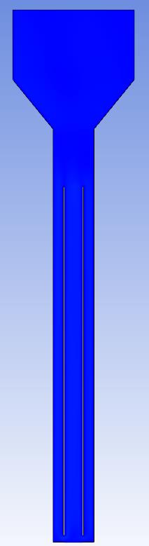

    • Jamessmp23
      I found a solution, there is a bug on Fluent CFD post which have different results in the same simulation. I had asked some professors in this field their experienced this problem too.
      For my understanding, using Fluent to see the results (contour, vector, etc.) is more accurate than using the CFD post.
      CFD post is much more user friendly but their an error for some simulation.
      Here is the comparison between Fluent graphic result and CFD post. If I made any mistake or misunderstanding please inform.
