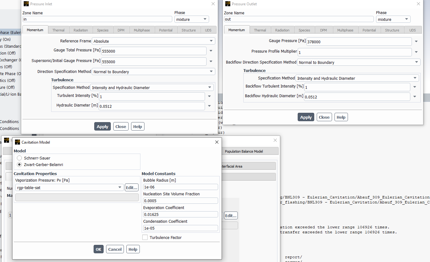

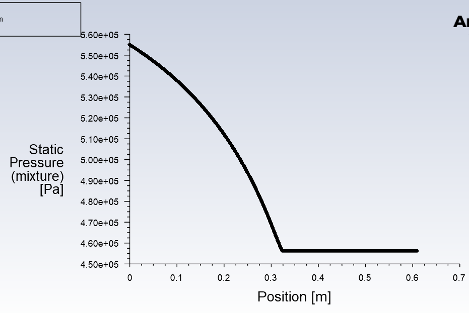

      I am trying to simulate flashing flow of water in CD nozzle in Fluent using Eulerian with thermal phase change model. However, the solution is not converging. I tried changing the scaling factor, still no improvement. Mesh quality is good.
      I also tried default cavitation model (Schnerr-Sauer/ Zwart-Gerber-Belamri). In this case convergence is good, but outlet pressure changes to saturation pressure, which is strange (Fig is attched). I have tried both with constant vaporization pressure as well as with UDF. How can this model breach outlet boundary condition, which was imposed?

    • amkum
      Dear Dr. Amine,
      I am simulating BNL309. A screenshot is attached for cavitation model. Please suggest where I am going wrong. When I used UDF with Mixture flow model, the pressure profile was correct. Fluent crashes if I use same UDF with Eulerian model.
      However, without UDF, outlet pressure changes to saturation pressure with Zwart-Gerber-Belamri with both mixture and Eulerian model.

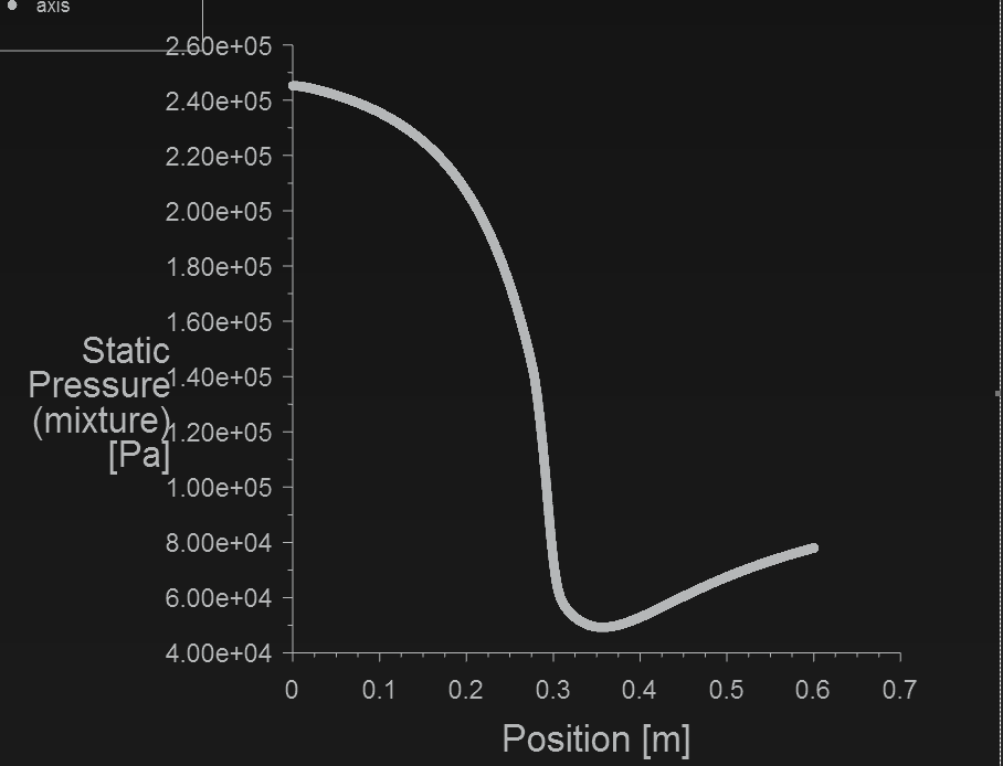

    • DrAmine
      The UDF should be checked if it is crashing with Eulerian Model.
      I used RGP tables for Abuaf nozzle and the results were fine. The difference might be that I used expert commands to avoid clipping the pressure as psat. For that reason using UDF for cavitation is also okay. Also bear in mind that Fluent post-processing does limit the pressure to psat when using built-in cavitation model. There is a TUI command to disable that. It is always best to expand the tables with total ranges not only static. The warnings are only printed for static values. I used these limits in my case (again perhaps we are not referring to same case)
      Pmin:   1.000000000000000e+05
      Pmax:   2.500000000000000e+07
      Tmin:   3.000000000000000e+02
      Tmax:   7.000000000000000e+02
      I obtained this pressure curve:

      But I am still struggling with the cavitation model. I tried setting up the pressure limit by using /solve> set limit. Still, the minimum pressure is clipped to the saturation pressure. Can you please share the TUI command to avoid clipping pressure to psat when using built-in cavitation model? . I tried to find TUI command to disable that. However, I could not find it.
       Please help me with this.
      Thank you
    • amkum
      Dear Dr. Amine,
      I can resolve the issue which I was facing in the cavitation model. I found the command in Fluent user guide manual.
      solve/set/multiphase-numerics/heat-mass-transfer/cavitation/min-vapor-pressure
      To see the actual pressure contours, use the following text command:
      solve/set/multiphase-numerics/heat-mass-transfer/cavitation/display_clipped_pressure?
      display clipped pressure in the post-processing [yes]: no
