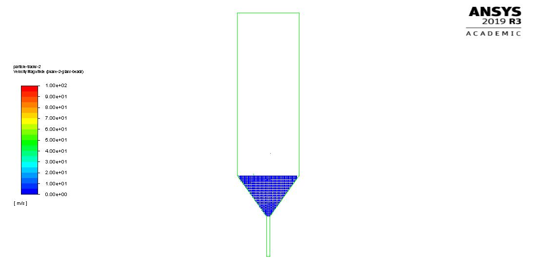

SubscriberRunning first time step successfully injected the particles in the bed and an initial bed height was achieved. Now for the remaining time steps, I want to include air flow in the spouted bed. What could be done to prevent injection of a new set of particles in the bed in the consecutive simulation run, without disturbing already settled particles?
I have attached a snapshot of the initially settled particles.
June 8, 2020 at 6:23 pm
Amine Ben Hadj Ali
Ansys EmployeeSet stop time to zero and particle mass flow to zero. -
