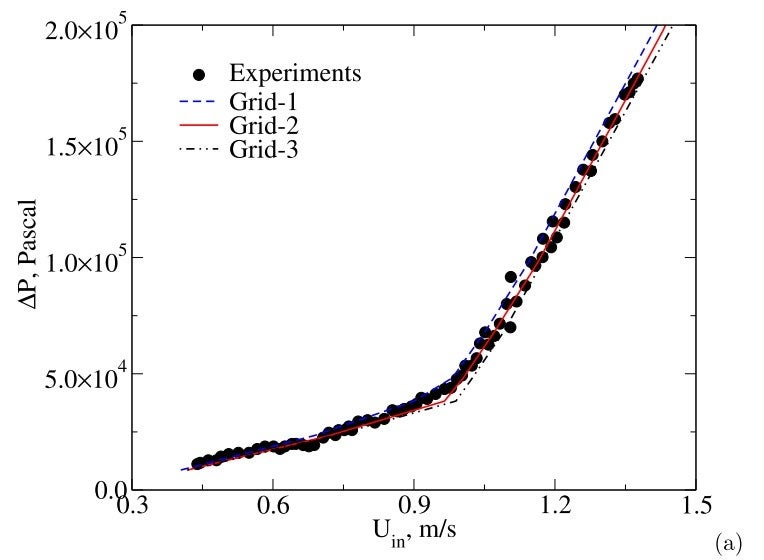

I'm currently studying the flow inside a venturi tube. The aim of the simulation is to investigate the cavitating behavior depending on the inlet velocity and reproduce the plot found in the literature (please see the first picture).

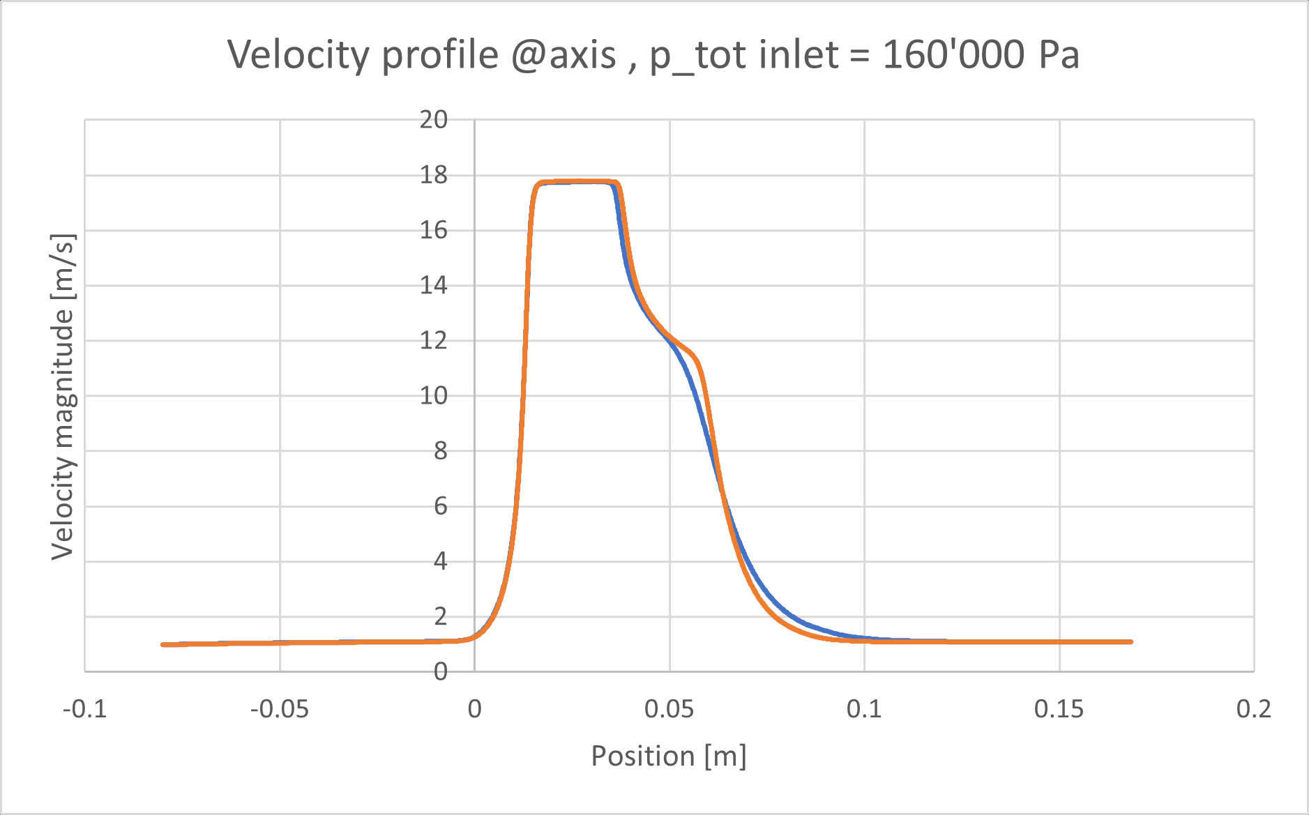

SubscriberDear Rob Yeah, I kept a low maximum aspect ratio in order to reduce the cell dimension in both streamwise and spanwise directions. I also have monitored the mass flux balance and the inlet velocity and outlet velocity vs iterations. I observed that with a relatively high value of pressure inlet , apart from the residuals, the continuity is not respected and the velocity in outlet waves like a sinusoid around the inlet one and is not capable to tend to the inlet velocity value to reach the convergence.
The contour of the finer mesh seems acceptable, similar to the coarse one, and I report a comparison of the velocity profile at the axis between the coarse and fine mesh:
It could be a problem between a very fine mesh (Yplus <= 1) and the cavitation model Schnerr-Sauer? Because I have no other ideas to solve this issue.
Thank you very much.

December 24, 2021 at 11:42 amRob
Forum ModeratorIf you're using the steady solver it sounds like the cavitation isn't stable and the problem is down to that. A very fine mesh may pose some stability problems if the vapour is added into one cell, but it's more likely the motion of the vapour.
