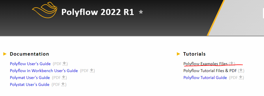

SubscriberHi Yi
Thankyou for the comment. But I am unable to download the example. I am using the university licence for running the software. I don't see any personnel Account Number(Customer Number) for me.
How to get that?
Best wishes Gaurav
March 3, 2022 at 2:46 pmydai
Ansys EmployeeHello Gaurav I asked our forum moderator who let me pass you an instruction below. Please check if it works on your side.
Our student users aren't provided access to the ANSYS Customer Portal, but we do provide students with access to the ANSYS Online help from within the ANSYS Student products. This access bypasses the need to login into the Customer Portal when using the online Help from within the Student Product, but that path isn't taken when you click on a link in a post here. The workaround is as follows:
1. From ANSYS Workbench, use the menu Help > ANSYS Workbench Help.A browser window will open.
2. In the post that has a link to the ANSYS Online Help,Right Mouse Buttonon the link and selectCopy Link Address 3. Go to the browser window that opened in step 1 andPastein the address bar and you get to the required page.
Thanks
Yi
March 3, 2022 at 6:51 pmydai
Ansys EmployeeHello Gaurav is it true that you are able to access the online help site and could view the document, but you are not able to download file from the site?
Thanks
Yi
