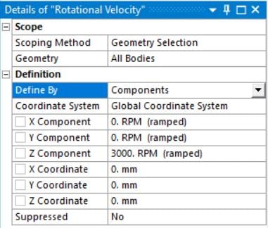

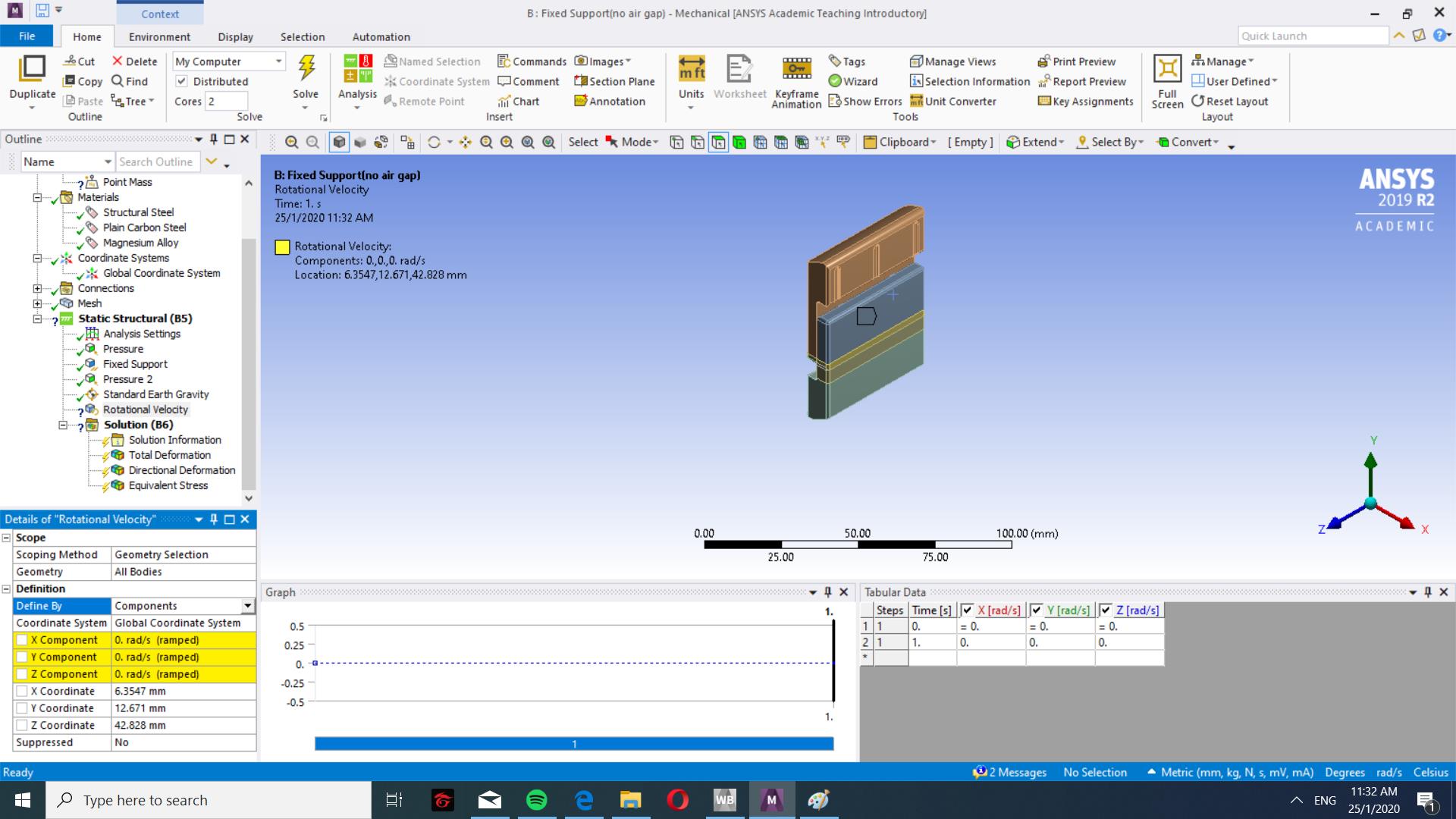

      Apply the Rotational Velocity load to All Bodies in the model and specify the axis at the center of the rotor, and enter the 3000 rpm into that load.  On the Home tab, you can click the Units button and set the units to RPM.
      In my model, the rotation was about the global Z axis, so I could enter the Z Component and use the coordinates of a point as 0,0,0 to define a 3000 RPM rotational velocity.  Does your rotor axis pass through the global coordinate origin?  If not, enter a point that is on the rotor axis.

      You apply the axis of rotation of the rotor simply by entering the global coordinates of any point on that axis into the Rotational Velocity load. I showed an image of that above.

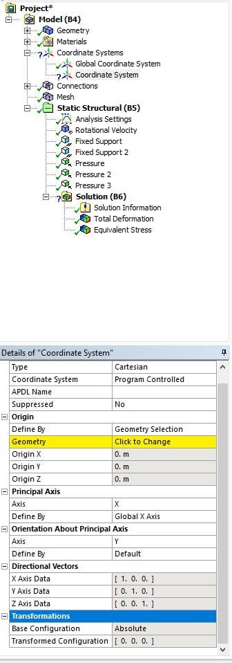

      In addition, do u have any shortcut on how i can find the coordinates of the rotor centre? the vane is modelled as a part file and i assembled in together with the rotor as an assembly. for the vane simulation i will be usingg the part file of the vane.
      The vane makes contact with the faces of the slot in the rotor. That is where 5 out of 6 constraints should be delivered by Frictional Contact definitions, and only the tip constrains how far out of the slot the vane can go.
      You have to use the CAD system to find the center of the rotor. You could open the geometry in SpaceClaim to do that if it is not clear from SolidWorks, but do this on a copy of the model as opening the geometry in SpaceClaim might break some of the model scoping if it was never opened in SpaceClaim before.

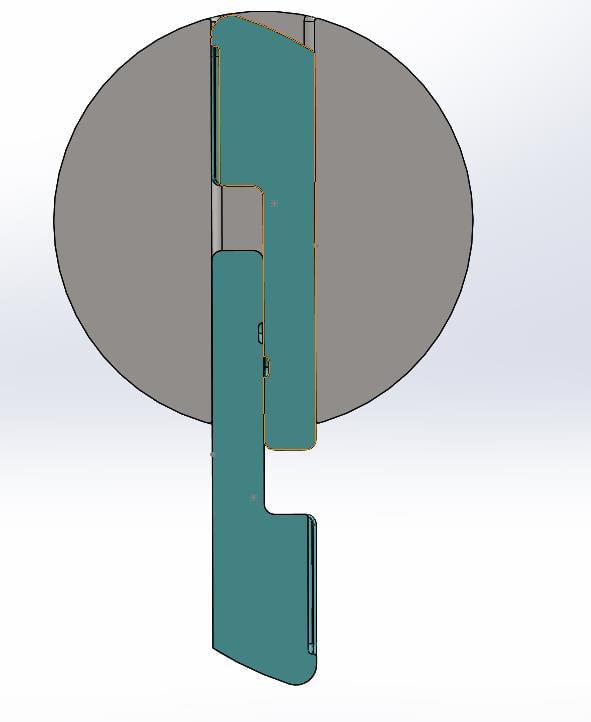

      everything works, thanks a lot. however I will need some advise from u. due to pressure acting on the side of the vane, the vane will be slanted rather than upright, hence not all the surfaces inside the rotor will be contacting the vane due to clearance.
      I have attached the photo here for your reference. the left vane will slant left(clockwise) with 2 line support (in green).the highest line support is due to the contact with the other vane. the 2nd lower line support is due to the contact with the rotor. Is it ok to use fixed support in this for these 2? I tried using displacement with x=0 but the constraint wasn't enough.
      there will be another support at the bottom tip of the vane which is in touch with the cylinder and we discussed to keep the y component=0
      Fixed support on two green lines is a bit of an overconstraint.
      Let one green line have X and Z = 0 displacement, while the other green line has an X = 0 displacement.
      The vertex at the tip of the vane continues to have the Y = 0 displacement.
      That leaves rotation about the X axis a bit underconstrained.  See if it will solve.
      If it will not solve, add Z = 0 to the vertex at the tip of the vane to prevent rotation about X.

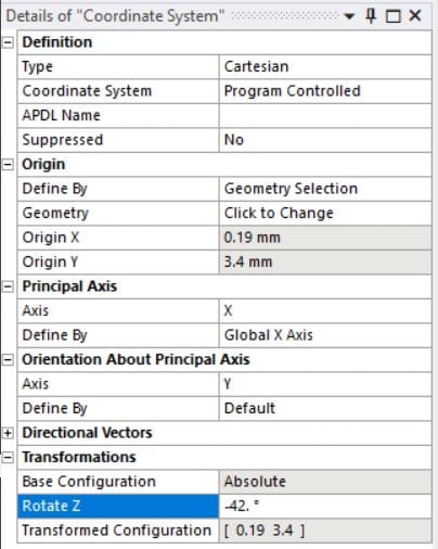

      Standard Earth Gravity doesn't allow you to use components.  Create a Coordinate System. If you click on the Coordinate System tab, there is a button to Rotate Z.
      Now you can use that Coordinate System in the Standard Earth Gravity load.

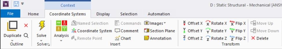

      i cant find the rotate z axis button inside transformation. may I know how do you find that? even after I click the geometry it is still the same old screeen
      is there any way to ensure it is direct solver instead of iterarive solver. what I meant that if I used this boundary condition like fixed displacement. I get result A, then I delete this "boundary condition" and add in the same "boundary condition" but I get result B
      When you have a Coordinate System selected in the Outline, click the Context Tab and see the Coordinate Systems ribbon. Look on the ribbon, there is a 3x3 array of small buttons in a Transform section. The top left small button is Offset X,  keep looking and you will see Rotate Z.
