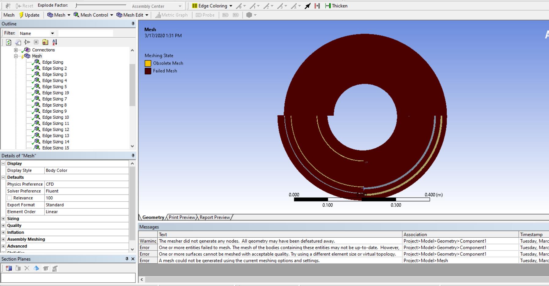

SubscriberI have successfully ran the simulation of spiral plate heat exchanger. Now I am trying to run the simulation for 2D case. I have created required geometry Design Modeler and Spaceclaim. When I create my geometry in Design Modeler, in cell zone condition it is showing contact regions and I can't seem to apply system coupling option to wall.
In case I create my geometry in Spaceclaim I get folloeing errors:
Any idea how to solve this ?

SubscriberI use system coupling option when there is heat transfer between two walls or wall and fluid and generally it was available when I was doing 3D simulation. When I use share topology option in Design Modeler case, some faces are missing. When I use share topology option with SpaceClaim , system coupling and thermal coupling option are showing but still I can't get cell zone condition which I have assigned. I have meshed geometry in ANSYS meshing and I created necessary Named Selection there. In 'Check Geometry' option there were no problems found.

Ansys EmployeeShare topology is used to get conformal mesh between different volumes.Â
Please check
https://www.youtube.com/watch?v=IO4ZtwZdD2I
When you use share topology between two volumes, you will get single face between two volumes. This face is shared by two volumes. So this common face will have cells on both sides.Â
If you do not use share topology between two volumes then you will get two faces at the connection. Each volume will have one face. Now as volume ends here, it will have cells only on one side. Meshing identifies the faces which are at the same location and creates contact regions. These contact regions can be used for defining interfaces and use it for non conformal mesh.Â

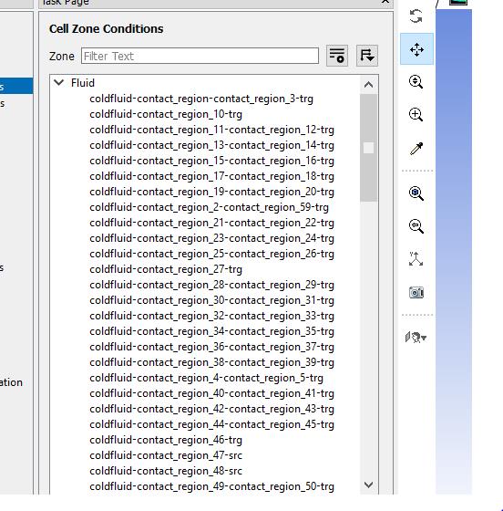

SubscriberThank You, I have figured out how to use shared topology. If I use share topology option I am getting coupled option for wall in Boundary Condition but I am still not getting my named cell zone condition in ANSYS Fluent.

In order to get your proper cell zone names, please create a Named Selection for your 'Volume' and not just for the boundaries. For example, if all the volumes in your geometry are part of the same single fluid, please go ahead and provide a named selection to this volume - let's call it 'Fluid'. Instead of seeing different parts under cell-zone in Fluent, you will see the name 'fluid' here.
Please note that material properties are added at the cell zone level. So, if you have multiple solids in your computational domain, please create separate named selections for them. This will allow you to add material properties later in Fluent appropriately.

SubscriberI have done exactly like this and still it is not showing in ansys Fluent.

Are you able to get at least one of your named selections as cell zones? Could you please share a side by side comparison of screenshots from Meshing and Fluent so we are able to clearly see the issue?

Ansys EmployeeDid you give named selection to edges or faces or bodies?Â
also make sure that you have share topology done to get conformal mesh.Â
Also give named selection bodies in meshing. You can give single named selection to more than one body.

SubscriberFor Cell Zone I have given name to bodies and for Inlet and Outlet I have given name to edges. I have made sure to use Share Topology with merge option in SpaceClaim.Â

Ansys Employeeplease run a test. reduce the problem size to identify issue. Â
keep only two bodies in meshing. suppress everything else.Â
then post images of meshing and fluent.Â
this is give more idea about connected mesh and bodies.Â
