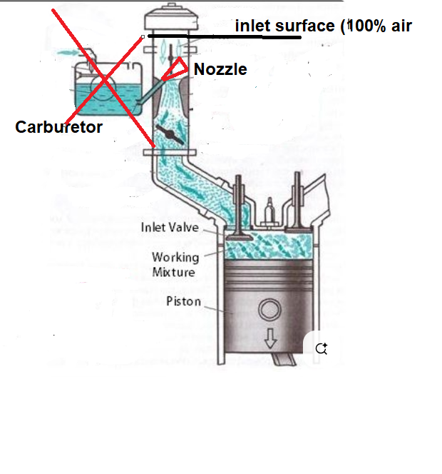

      Oh sorry, I thought you were trying to model the entire carburetor.
      There is no “setting” to simulate the presence of a carburetor, but since its job is to distribute tiny droplets evenly into the intake air stream, you can reverse-engineer something. To give the spray time to spread and break up, your model will have to include the orifice and venturi.  So you can start the intake geometry upstream of the venturi as shown below:

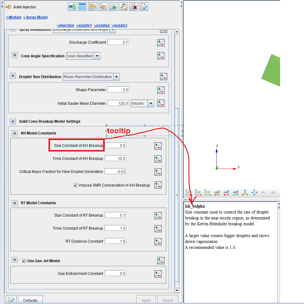

      The fuel passage would start from the nozzle that opens into the venturi. A solid cone injection nozzle is probably the most appropriate choice, as most hollow cones are generated by swirl with film formation. You could set a constant droplet size or Rosin Rammler distribution, depending on your literature findings.  The secondary droplet breakup models will break the entering droplets up further and create a fine mist.  The parameters of this model, and the incoming droplets, may have to be adjusted to generate smaller or larger particles downstream. (To find out what each breakup model parameter affects, mouse-hover over the parameter names):

      Thanks will get to do this at some point, will find out what suitable academy fuel library file to select and start with default KH setting, then validate. Will have to find out what fuel chemistry file works best, not sure if Gasoline_1comp_49sp.cks works.
    • jcooper
      If you have gasoline, if should work.  A small mechanism is best to start so that you have a case that turns around more quickly and allows you to learn from it faster.
