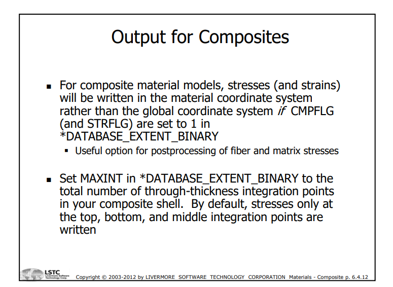

      Have you set MAXINT in *DATABASE_EXTENT_BINARY to the number of layers in your layup to output results for each through the thickness integration point?
      You can also set CMPFLG=1 in *DATABASE_EXTENT_BINARY to write stress and strain results in the material coordinate system.

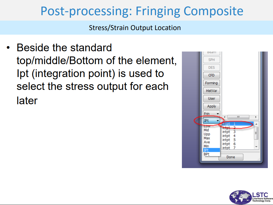

      For the benefits of others: once you have set MAXINT in *DATABASE_EXTENT_BINARY, you can post-process the results in each layer by looking at the IPt results in LS-PrePost and selecting the appropriate integration point number:
      Reno.
