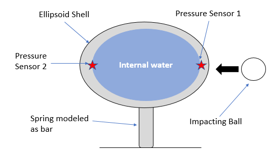

      Hi everyone,
      I am trying to create a simulation to verify the following experiment: a 3D printed ellipsoid shell is filled with water and attached to a spring which is fixed to the ground (See image 1). We have positioned pressure sensors on the internal shell wall in both the coup and contrecoup regions (this experiment has to do with correlating impact acceleration to internal pressure for investigation of traumatic brain injury). Our ellipsoid shell is then impacted with a mass attached to a pendulum and the corresponding internal pressure values are recorded.
      I am trying to model the fluid structure interaction of the internal fluid when the ellipsoid is subject to an impact from a ball (see image 2). So far I have been trying to use the ALE method (defining solid bodies as Lagrangian and fluid bodies as Eularian), but I am seeing unexpected results where the internal fluid compresses when in contact with a Lagrangian body and the aft fluid region does not deform at all (see attached GIF).

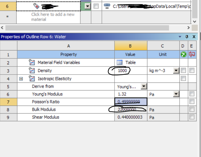

      2. Why is my fluid body not behaving as a fluid contained within the shell? - is there a certain element type of water material definition I should be using? (I am currently defining water based on a Explicit Dynamics example for a soda can being crushed where E=1.32Pa, and Poisson=0.4999)

      Hi
      Yes, the first one is the material. See below for water (just isotropic linear to start with).
      The second one is the interaction. So suppress all contacts and insert only a body interaction.
