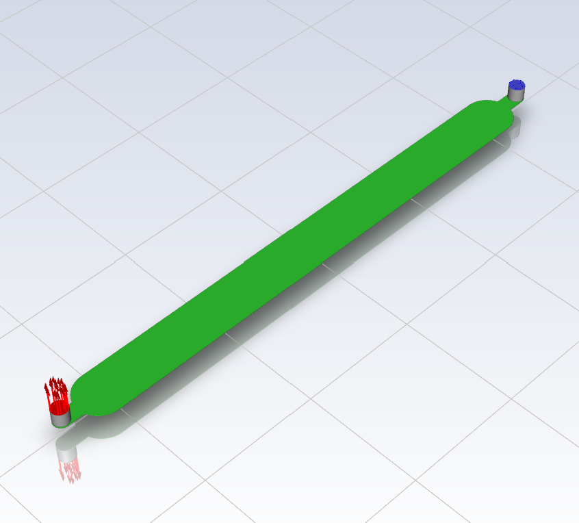

      I'm trying to simulate a microfluidic device in 3D Since it has unique wall materials on different inner surfaces. I looked up many tutorials but they are all in 2D. Every time I run the calculation y velocity and residue go sky high and end up in a floating point error. Any suggestions? Many thanks.

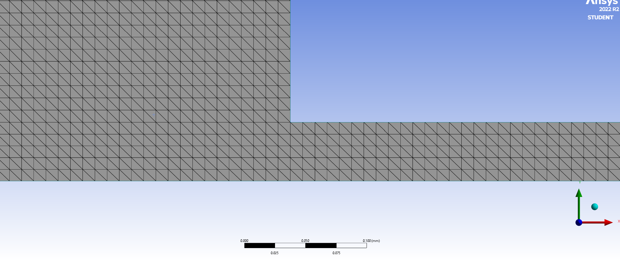

      Post a few images of the mesh - knowing what you're doing tends to help provide answers.
      • Zhongrui Liu
        I have a channel that is 50um thick, 3mm wide, and 30mm long with 1mm wide inlet and outlet vent on the sides. I initially want to simulate how liquid enters one of the inlets and seeps through the channel by capillary forces. However, the inlets are huge compared to the channel, and I think the mesh on the thin channel is messed up or too large. I moved to 2D, reduced channel length (so I need fewer nodes and can use finer mesh), and tried multiple methods to mesh. The only one that made it to completion without floating point error is the triangle method shown above but the results are pretty weird -- at least compared to what I see in the actual channel in the lab. I suspect the mesh is simply too large but I don't know any better ways to refine it without using too many nodes.

          You are going to want a more resolved near wall mesh. To get the proper angle of contact at the wall surface you will need several elements to capture this gradient. Six across the channel will likely not be enough.

      As NickFL has noted you need a lot more mesh, and I tend to favour pure hex in these models where possible. It's also more efficient in terms of cell count. With capiliary driven flow you're also looking at resolving the wall adhesion, and the increased cell resolution (smaller cells) also tends to reduce the time step you can use. These models are fairly easy to set up, but significantly less easy to get good results from.
