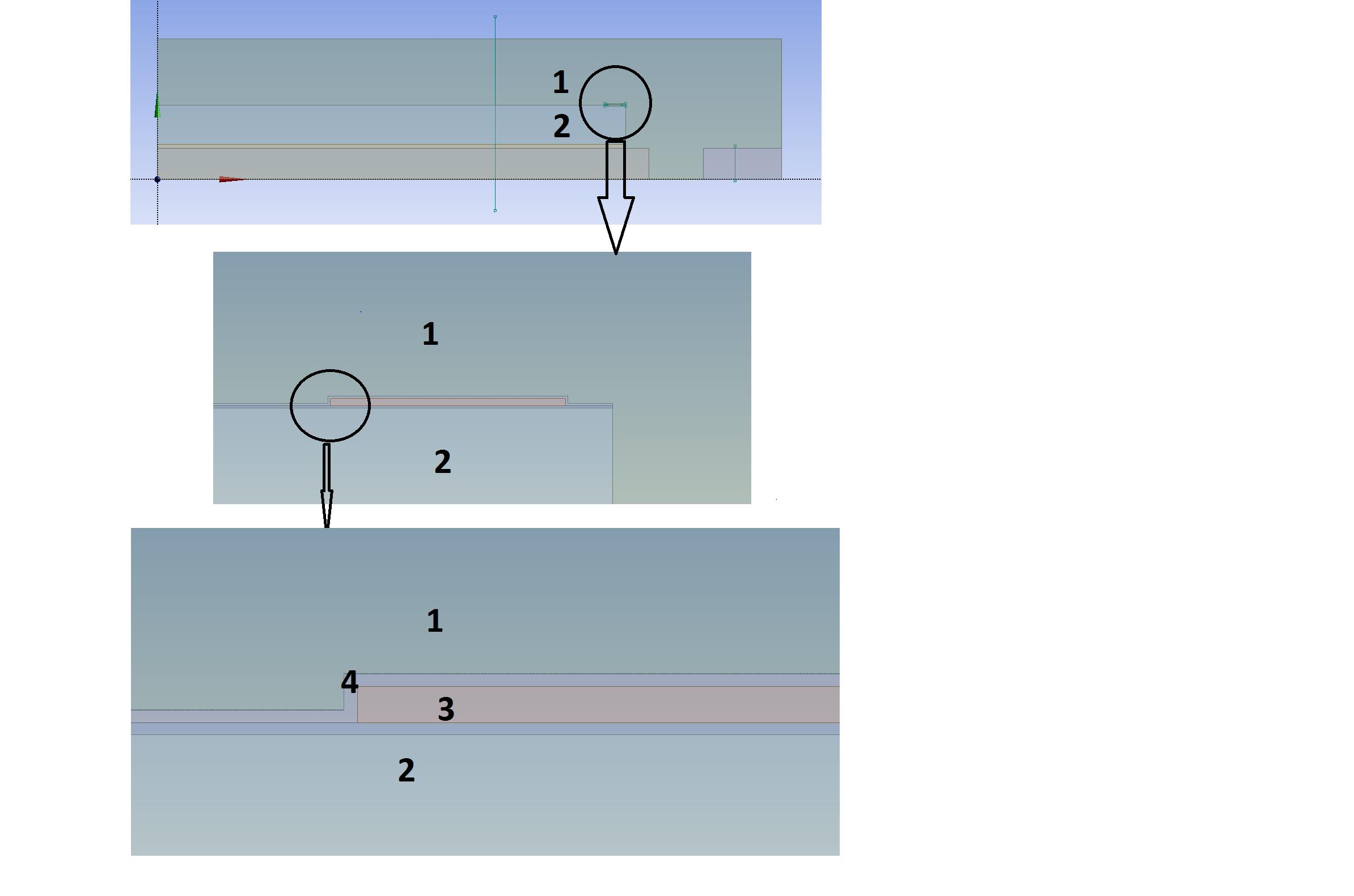

      I have a structure like the below: body 3 and 4 are very thin so you cant see it in the global model. To generate better mesh. I want to partition body 4 with the sketch in the bottom figure to avoid the sharp corners. Finally , I want part 4 is made up of rectangles and squares. However, when I tried with face split with the line I draw, I always get an error:
      Error: Facesplit failed; cannot project selected set
      Additional information: Face Split Group 1
      Context: FaceSplit Feature FaceSplit15
      If I do face split on part 1 and 2, there is no problem. I searched online but could not find useful information about this error? Is there something wrong with face split if it is applied on very thin part? Or is there any tolerance I can set to avoid this issues?
      Thanks
    • Keyur Kanade
      create a sketch with an edge
      then you can create a line from edge using concept > line from edge
      then use tools > project to project this line on the face. it will split the face.
    • cyx9078
      Thanks.Later I turned to SpaceClaim and its split function worked.
