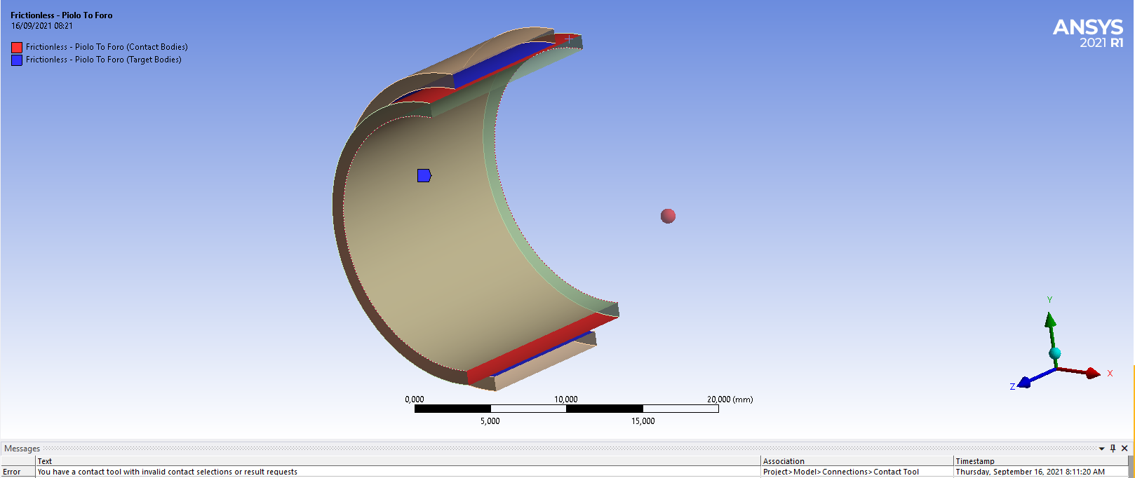

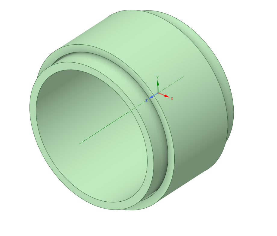

SubscriberHello, I'm trying to understand how contacts work in Mechanical and for this reason I've set up the following simple static structural simulation:

Ansys EmployeeHi I would use a remote displacement to move the cylinder in the direction you want (say X), this will make sure that the model is restrained OK, since now something is not working - also use the initial contact tool to see that gaps of the contacts are closed.

SubscriberHello Erik I've modified the constraints according to your indications, replacing the "Displacement" constraint with a "Remote Displacement" constraint and forcing any rotation to zero. Moreover I've used the "Contact Tool" as per your advice. An error warning says that "You have a contact tool with invalid contact selections or result request". I dont really understand where the contact error can be, since this Contact is very simple: Frictionless Type, One surface for Contact, One surface for Target and, as I previously noted, Normal Lagrange Formulation with Asymmetric Behavior (the convex is the Contact side of the pair and the flat/concave surface must be the Target one) Trim Contact OFF and a pinball radius big enough to "cover" the distance between the two surfaces.

Ansys Employeehi - never seen this error - I would start from the scratch and create a simple model to try and get the contact to work - say 2 blocks on top of each other and then pressing one down with an enforced displacement on top. try something simple first and see that it works.

Ansys EmployeeHi @Jourawski I'm assuming this is a static model, correct? If so then force controlled models with open contact are not well conditioned. The inner cylinder has no initial X boundary condition as the contact has not yet been established. The contact state is "open". The model is ill conditioned. So any applied X direction force to the inner cylinder will result in the cylinder moving to any possible position. And it displaces very far, so the message about internal magnitude limit being exceeded. For structural models the MAPDL solver has a default limit of 10,000,000 units of allowed displacement.
There are several ways of addressing this. One would be to displace the inner cylinder in the X direction until the contact is "closed" then deactivate the displacement while activating the X force. Another would be to introduce something for the inner cylinder to 'push' against until the contact is closed. This can be done with global stabilization damping (set in the Analysis Settings) or a local to the contact pair stabilization. There was a AIC video on this. The contact option "Adjust to Touch" could be used, but the 0.2 mm gap that needs to be closed seems to me to be a fairly large gap. Usually we use this on small gaps that are introduced via loose CAD tolerances or the result of meshing. But I'll leave the judgement up to you since it is your model.

you have a body (inner ring) with no reacting force (frictionless contact) that you assert force on, yeah it move, you have rigid body motion, then an error. so please try other types of contacts that are bonding or firctional or constraint the inner body by, fore example a spring.

I'm answering so late because I wanted to try different things and read some info in the User Guide. My (apparently) easy simulation had two critical aspects: firstly, the inner cylinder is too "free" to move. Even if there's a force oriented only in x direction, the cylinder must be correctly constrained. That means that no rotation must be possible and no translation in perpendicular directions (y and z) should be possible. ONLY one direction can let be possible, and this one is the direction the force is acting along. For this reason a remote Displacement is the right choice.
Secondly: Contacts. Since the distance between the contact side and target side can be big (the outer cylinder can be much much bigger), the contact can be open (in the beginning, at least). A frictionless, asymmetrical contact can be the right choice but, is MANDATORY to set a form of damping, in order to limit the motion of the inner cylinder during the motus before it touchs the outer cylinder. Stabilization Damping is definitely the right choice. It's difficult to predict the corrisponding value. As perfectly said in the YouTube video "Utilizing Contact Stabilization Damping Properly in Ansys Mechanical" you have to plot, during the computation process, or at the end of it, how big the Stiffness Enery is compared to the Damping dissipation Energy. The damping energy must be 3, 4 orders of magnitude minor than the the Stiffness Energy, since the damping agent, in reality, does not exist, so its energy contribution must be negligible so that it cant alter the essence of the problem you are studying.
