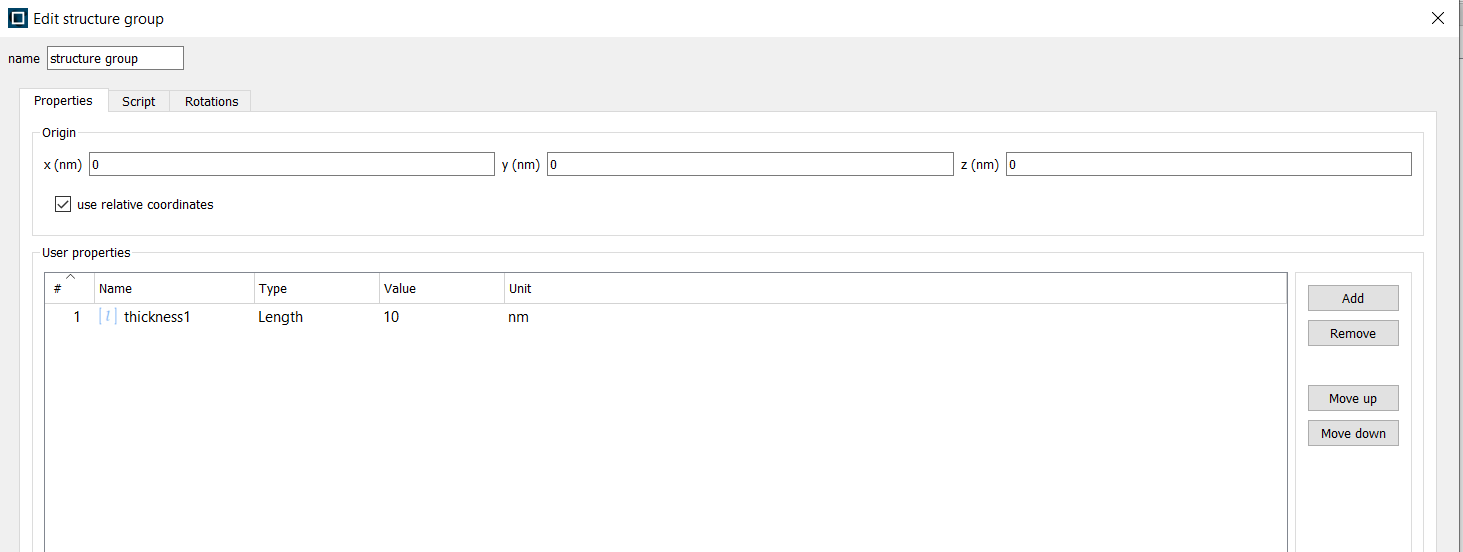

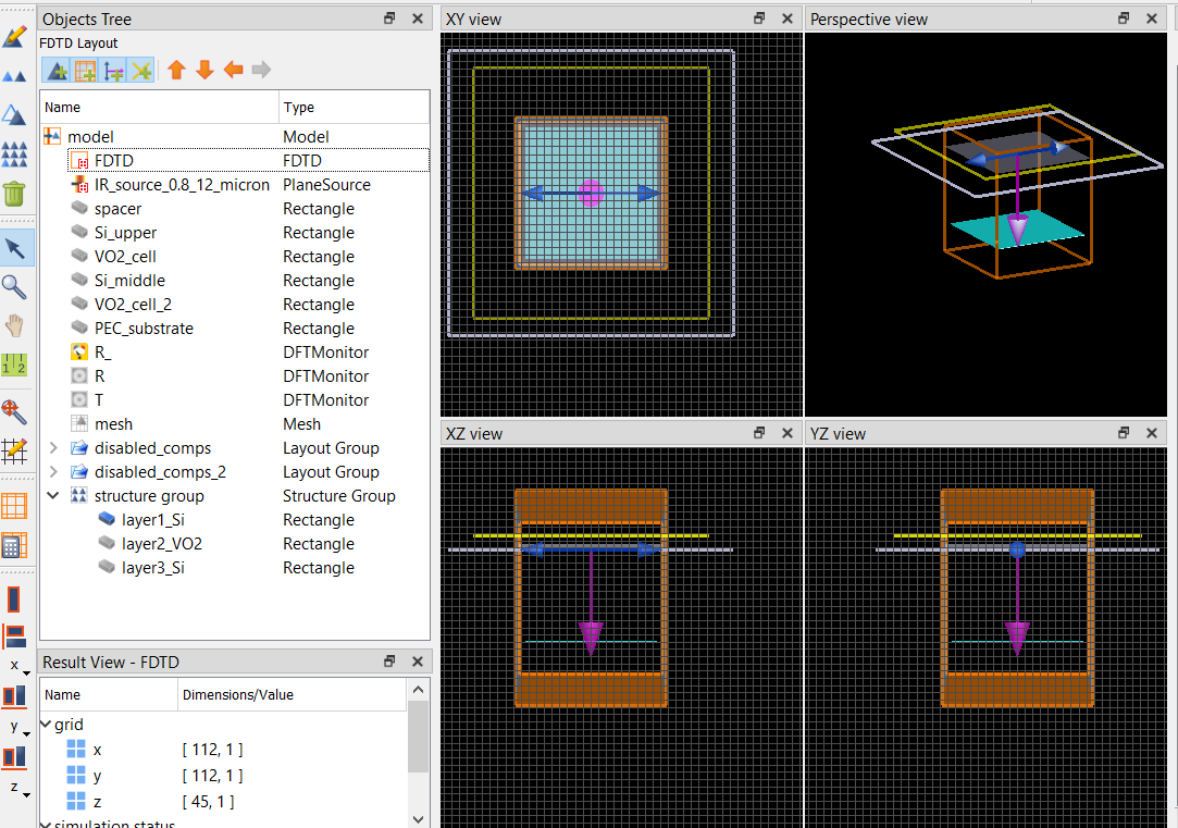

      Here is the desing and component tree of my simulation:
      "R_" is the monitor and I'm trying to extract value of "T". To do that I created a single layer structure inside of structure group and added a parameter which is "thickness1".

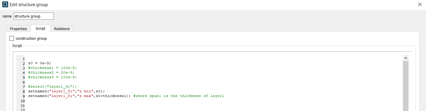

      Then I added this script:

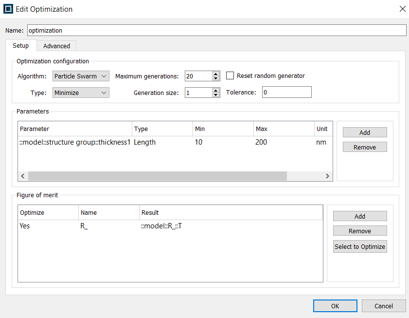

      And lastly, I made an optimization configuration:

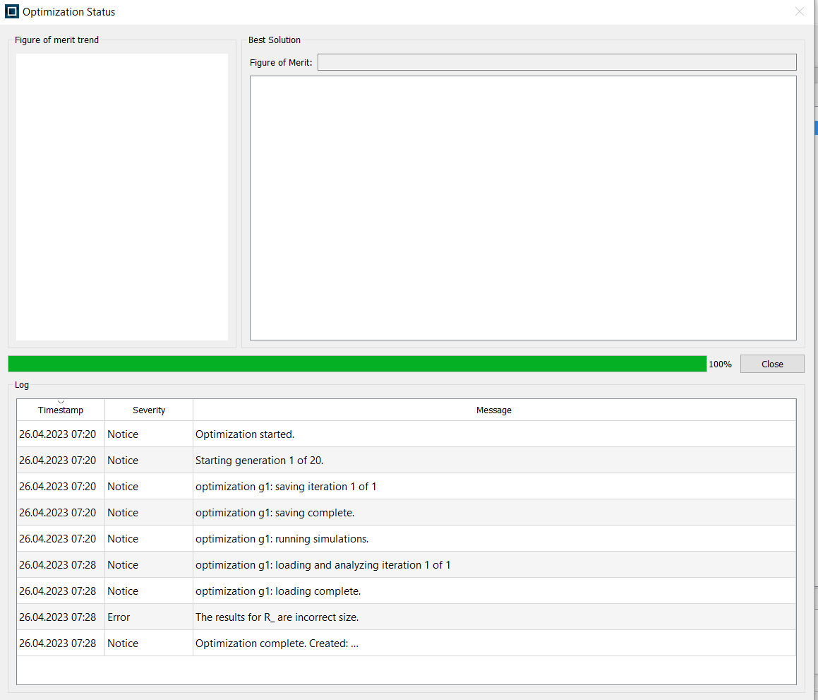

      After finishing the first generation of optimization it gives me this error, "The results for R_ are incorrect size.":
      I'm trying to fix this for 2 weeks and still no progress. I tried to follow up same steps in video I shared but have no idea about the problem. Any suggestions would be great.

      What is the size of R_, which has been extracted from the monitor T? You can use the size script command to do this. Are you recording this data at multiple frequency points? The in-built PSO algorithm in FDTD can only optimize a single-valued figure of merit. This issue might arise if R_ is an array/matrix. Please let me know if this doesn't work. Thank you!
      Amrita
    • atfkerem76
      Hello again. I was recording this data at multiple frequency points (1500). Appearently this was the problem. I tried this with a single frequency point and now it works. Many thanks.
