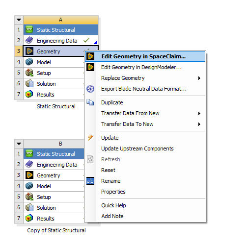

July 24, 2023 at 12:28 pm
Nanda
Ansys EmployeeHello Fluent user,
When you right click on geometry cell, you should be able to see "Edit geometry in SpaceClaim". If not you might have not installed SpaceClaim product.
Nanda.

July 24, 2023 at 2:40 pm
Fluent User
SubscriberDear Nanda,
thank you for your response.
Unfortunately, I cannot see it.
I don't have a licence for me, the university is sharing the licence with several students and we are working online (on remote, via DCV).
How to install the program in this case?
Best wishes
