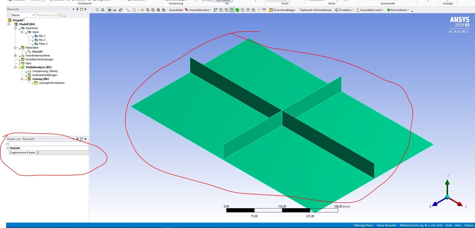

      Now here is the original image:
      I try to create a mesh in Mechanical.
      The geometry is quite simple. I think the problem is, that it can't find the material parameters. I already checked the meshing with my fellow students and our lecturer, who have the same settings. It is working for them. The only difference we were able to find is the problem you can see in the picture.

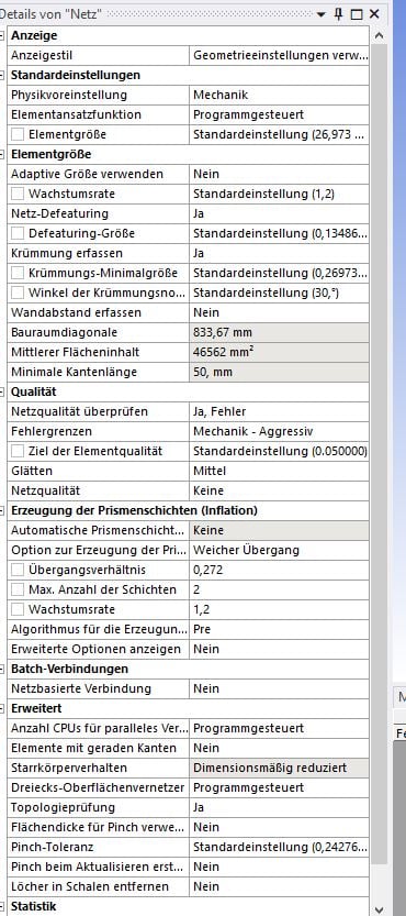

      Material parameters shouldn't effect the mesh, what settings do you have in "Mesh"?
    • ClemensPitschke
      If it doesn't affect the mesh I still wonder why the material parameters aren't shown when I click on them.
      Here are the meshing options. I installed the software in German, I hope this isn't a problem. Didn't find a way to convert into English after installation.
      I hope this isn't an issue. Otherwise I think I have to reinstall again?
      Kind regards.
      Clemens Pitschke
      Look at the element sizes, your min size (I think) is 50mm, but the domain is only about 600mm long.  Try a min size of around 1/4 the height of the ribs and check the other sizing is sensible.

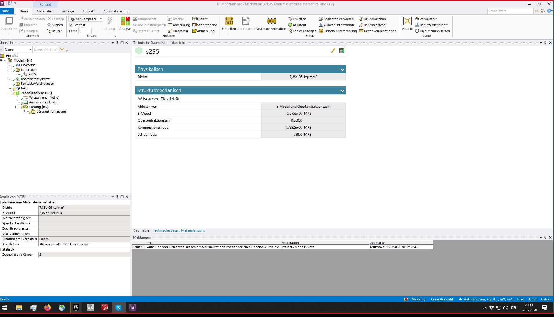

      Please consider the problem with the material. When he is clicking on the rider with the material the following appears:
      Why is it that I do not get this window and information about the material? Should I open a new thread for this problem, cause it is not a meshing problem but much more a viewing or connecting to database problem???
