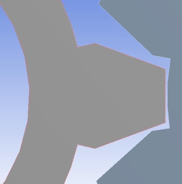

      You mentioned the input torque at one end, what is the output torque at the other end?  Why do you need the idler gears? Did that come from a space constraint?
      The shapes you show above don't look like practical gear teeth, there is no space between the tip of the tooth on one gear and the root of the gear hub on the mating gear. There should be a fillet radius at the base of the tooth to avoid a stress concentration. They also don't look like the teeth have an involute profile. Gear design is a special design task. What do you need to analyze?  It's pointless to analyze the stress in this geometry, these are not real gear teeth.
    • 3enrique
      It is not my gear design but the task is to analyze it and give feedback resulting from it. The fillets will be added later in order to compare both results. The last gear is connected to a shaft which will just rotate a shaft with a disk on top to measure the output speed.
      I think the analysis you are being asked to do is to calculate the output speed given the input speed.  That is a simple calculation on a spreadsheet using the pitch circles of the gears.  You can ignore the teeth, since they are not authentic gear teeth, just a visual outline to show that there are teeth. Do you need help calculating the output speed and direction?
      I downloaded your SW files, but I'm on SW 2017 and you have a newer version, so I can't open it. Neither can SpaceClaim 19.2. You need to Save As an older version of Parasolid and provide that file. You can attach a zip file containing the Parasolid file to your reply.
      I provided a lot of feedback on the tooth design in my last paragraph of the previous post.

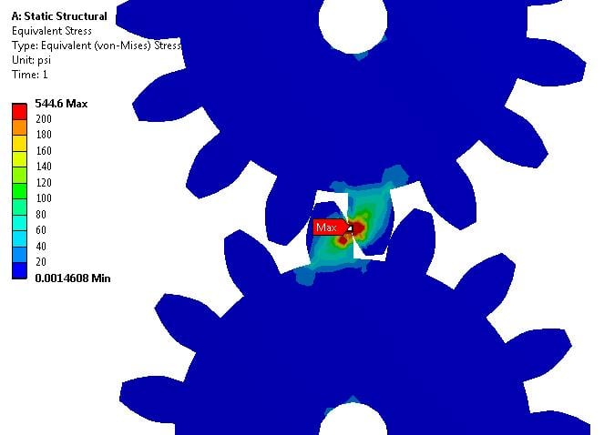

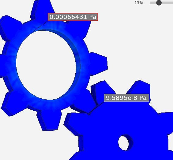

      This is what I'm getting for the first gears:
      It seems very small but it may be correct as the moment is just 3Nm. How would I go on to make the hand calculation you comment?

      Ah, now I see why you couldn't find a Revolute Joint, you're using AIM 19.2  not   ANSYS Workbench 19.2.
      AIM has a simplified User Interface so Joints are not exposed. Each gear needs two Frictionless Supports, one on the Cylindrical Face and one on the Flat face to make the equivalent of a Revolute Joint. I believe you can open Workbench and Mechanical to exposure more functionality, but then you are in a totally different User Interface.

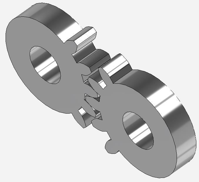

      I tried to use AIM 19.2 to do my own two gears, but had issues with it finishing its tasks.  It solved completely, but even leaving it overnight, it can't finish post-processing the results. The transcript  also shows it solved.
      I removed teeth from the gears to allow more elements to be used on the teeth in contact.
      Obtaining the stress is just an exercise in button pushing because these are not real gear teeth, they are not even close.

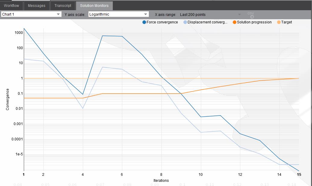

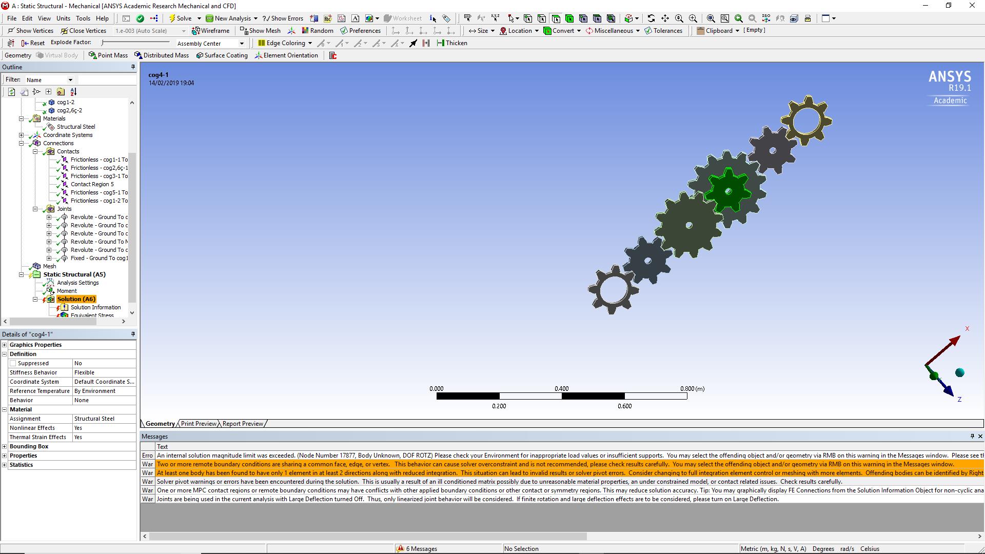

      I have tried to do it on workbench now and although I have found and inserted the revolute joints, I am getting errors. I have also inserted frictionless contacts between gears and bounded contact between both stacked gears.
      Here is the file: https://drive.google.com/open?id=1U1HYj3MgKq8keSl241HTxouZUAW8qE40

      It seems I'm not able to open it due to it having be saved in a newer format. I'm using Ansys 19.1
      That is correct, you can't open newer release files in older release software.
      I tried to download from your link but found you only put the .wbpj file and you didn't make an archive that is the .wbpz file.  The .wbpj file is useless on its own. Please create an archive file.
    • 3enrique
      In the CAD, all the gear teeth have to be oriented so they are touching in the direction that the load is going to transfer the force. In your first mesh, there is a 0.5 mm gap.  You have to rotate one gear to close that gap before ANSYS can solve the stress in a Static Sturctural analysis.

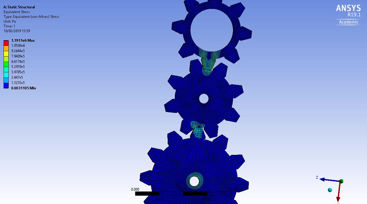

      Thank you that seemed to solve the error, though I'm still getting some warnings. I am also not sure that the result I'm getting is correct, though getting one is a big step.

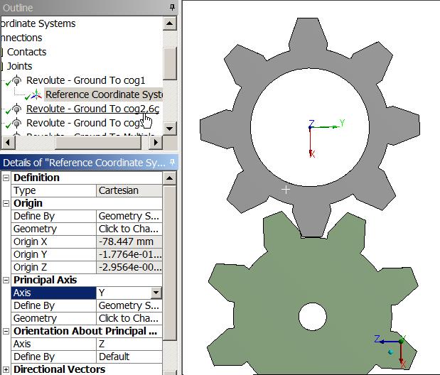

      Here is the file: https://drive.google.com/open?id=1uj66xEZvo_4nTGjCZD6H7smMxnsq5IU5

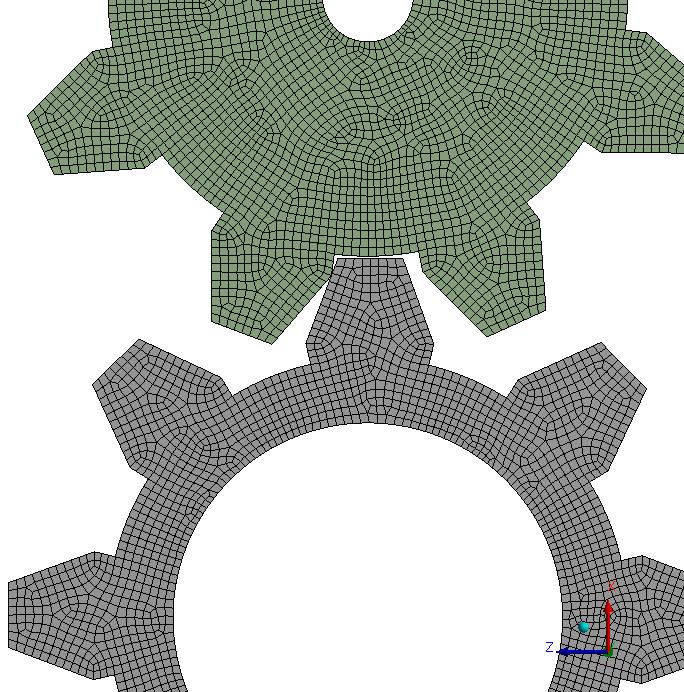

      Here is a simpler version of your model with just two gears. Look at the first Revolute. The Z axis, which is what the rotation is about, is pointing in the wrong direction! It has to be aligned with the cylindrical face axis. It is not at the center of the gear. You have to pick two faces to get it to snap to the center.
      In the image below, the Reference Coordinate System under the Revolute Joint has a new center and new direction for the Principal axis.
      I put a fixed support on the ID of the bottom gear since I suppressed the last gear that had a fixed joint.
      You won't get good stress results with such a coarse mesh compared with a fine mesh.

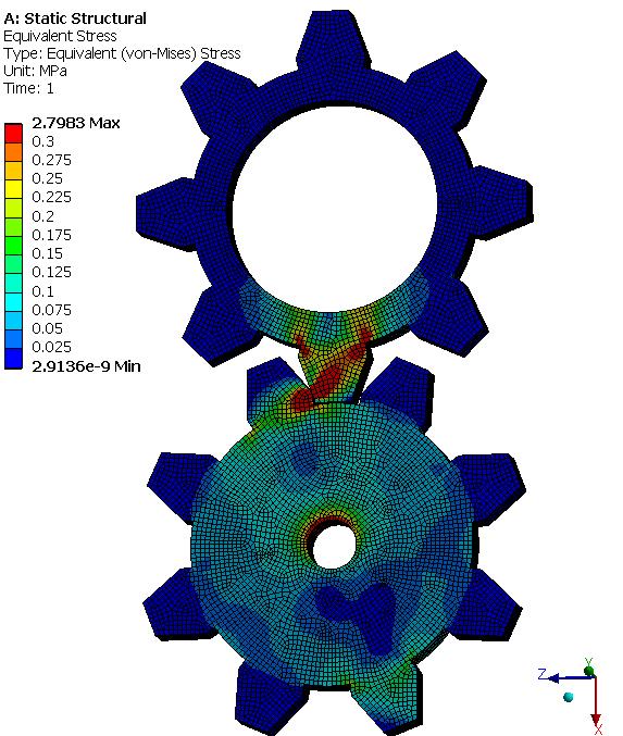

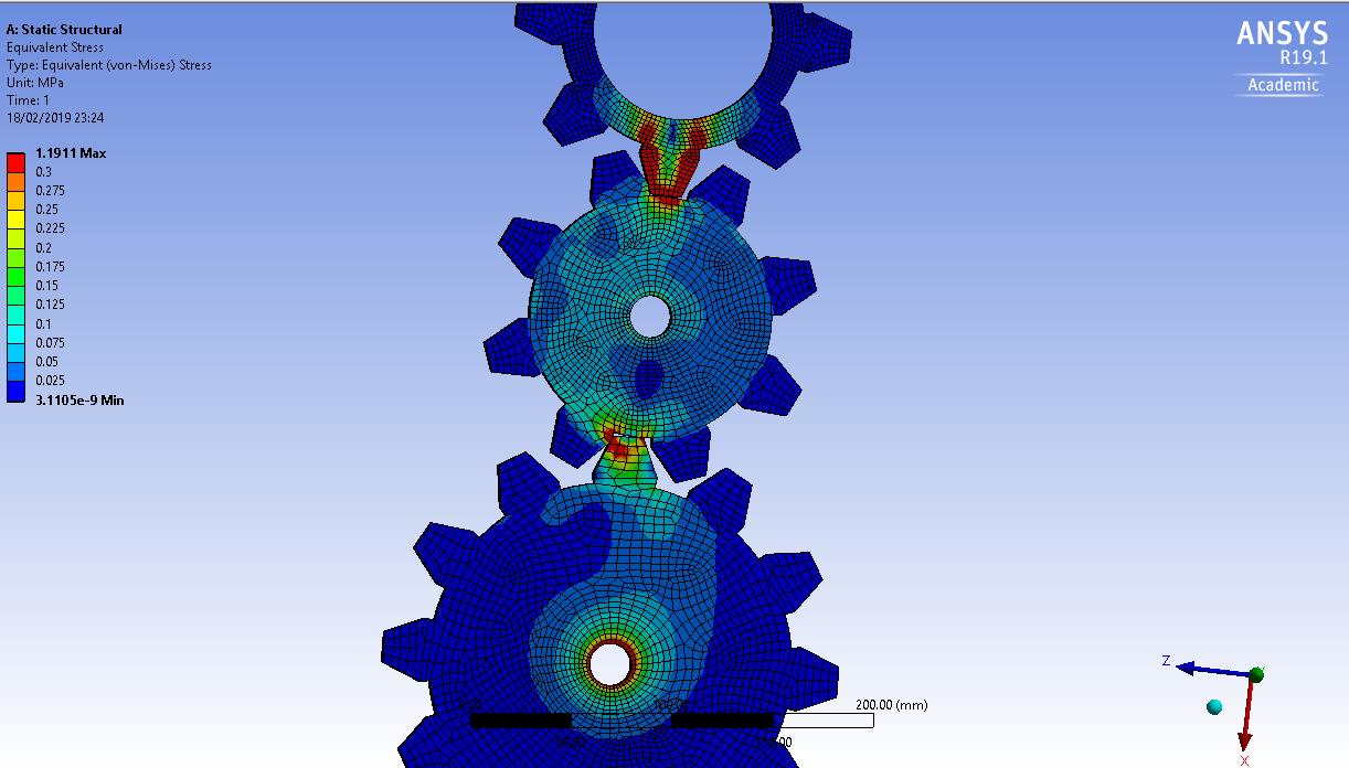

      Thank you very much once more. I've followed all your steps and managed to reach a solution which makes more or less sense for the model with 3 gears. However, I'm getting a different result to yours. Could you check if I've done something wrong?
      https://drive.google.com/open?id=1WXVobNPLd0LlogumBWPvUgVeJoSZB4xZ
      Please reply with an image inserted showing stress on the same scale as I show above.
    • 3enrique
      This is what I'm getting. The file is in my previous post. Values seem too low to me.
      Make your legend exactly match my legend.
      • Change units from m to mm which will change Stress from Pa to MPa
      • The number between orange and red, type 0.3
      • The number between dark blue and light blue, type 0.025
      • Click on any color in between, see the + and - sign popup?  Click the + sign until you have the same number of squares as my legend.
      Don't pay attention to the biggest number in my legend of 2.8 MPa and the biggest number in your legend, 1.2 MPa because I told you that this geometry has a stress singularity. That means the exact value of maximum stress is infinity. The smaller you make the elements the larger will be the calculated result. My elements are smaller than your elements so I get a bigger maximum value.
      But when you make the color scale the same, look at the distribution of color. It should start to look similar.

      This is it. It does look very similar indeed, though there are some variations. Still not sure if mine is right.
      I downloaded your model. The mistake in your model is your contact type is set to Bonded. Change it to Frictional. Then the contours will look more like mine. You might experience some difficulty getting the solver to converge because Frictional contact is nonlinear, while Bonded Contact is linear. You might need to turn on Auto TIme Stepping and set the Initial Substeps to 10 or higher. You must also insert a Contact Tool under the Connections folder and check that the Frictional contact is closed. If it is not, you must use Adjust to Touch in the contact definition.
    • 3enrique
      This is what I have got now:
      I think it's very similar, let me know what you think. I can't believe I had bonded contacts, I have done the same steps so many different times it must have slipped through. I made them Frictional contacts, though with 0 Friction Coefficient, which one did you use?
      Looks good. Gears generally have slippery teeth due to material or lubrication. I think you can close this discussion now by marking one of the posts with Is Solution.
