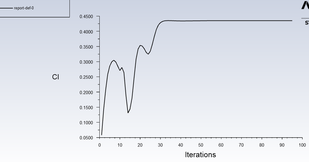

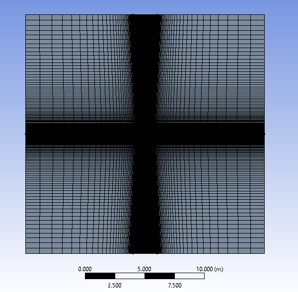

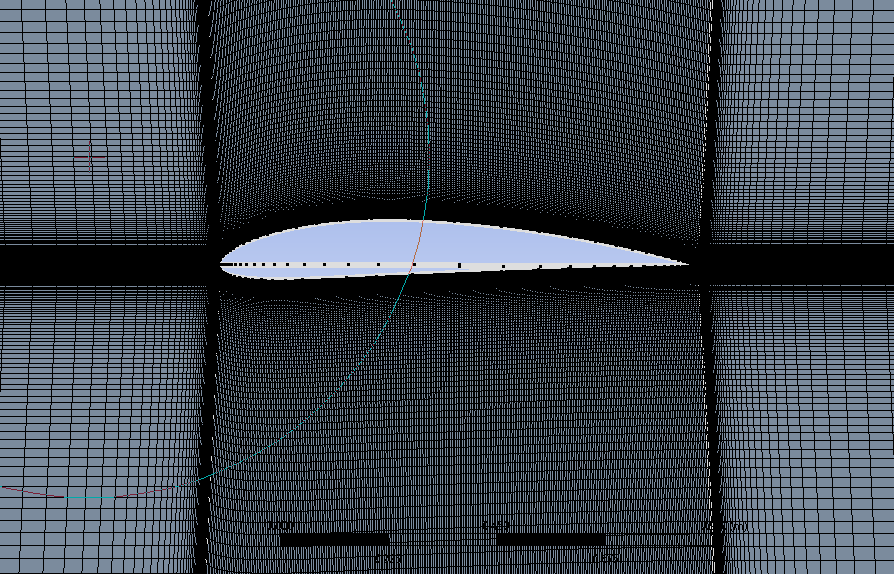

      Hello, a few days ago I asked help with a mesh, now I have troubles for the validation of a flow around a NACA 4412. I'm trying at 6° but Cl is too low and Cd too high, tried different models and it's the same. Also tried a NACA 0012 with a different type of mesh and it's the same. I'm leaving a few pictures of the mesh and setup.
      Probably I'm doing something wrong. Thanks.

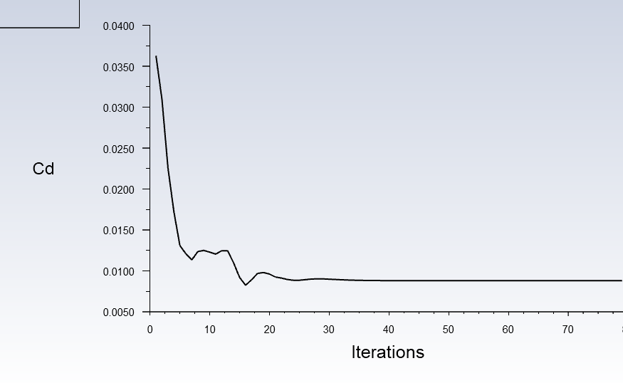

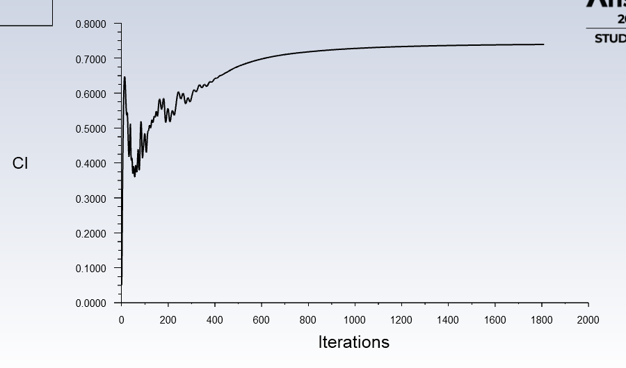

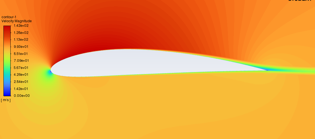

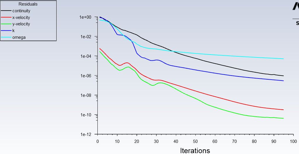

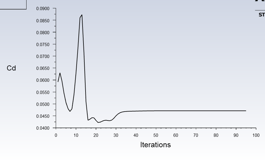

      • bianchini.1857628

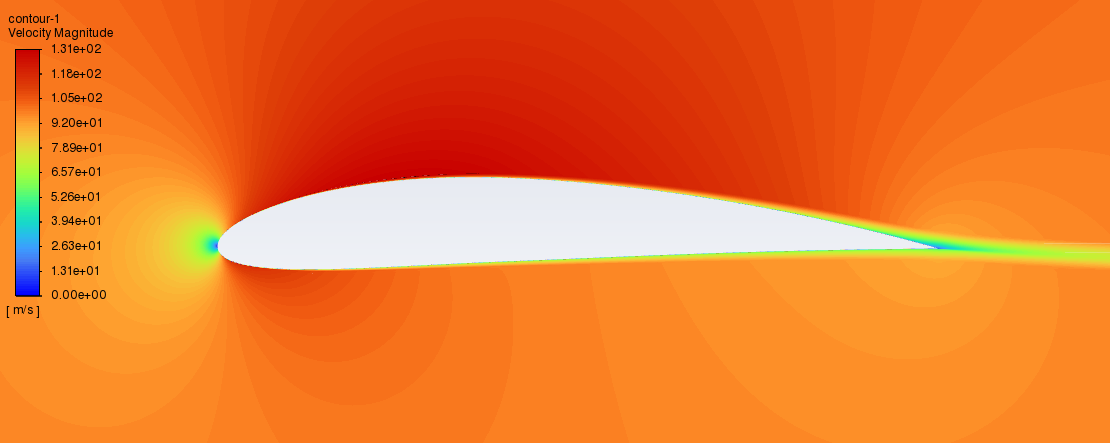

        Contour at 0°:

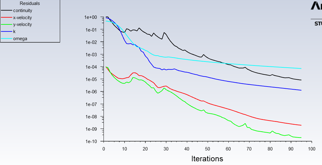

        Residuals at 0°:

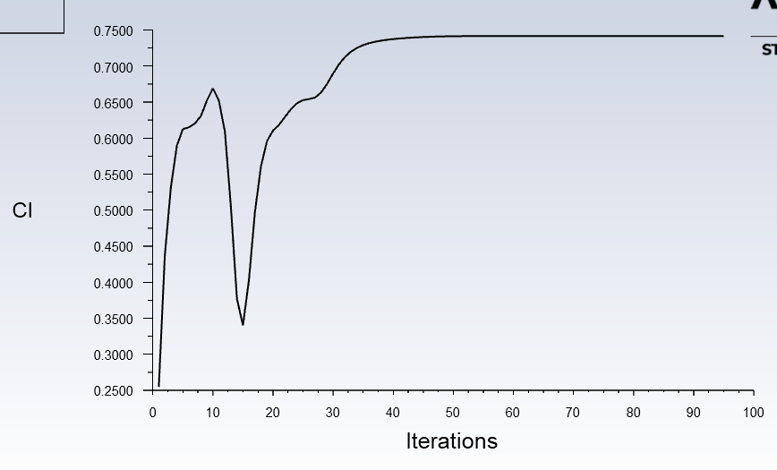

        Cl at 0°:

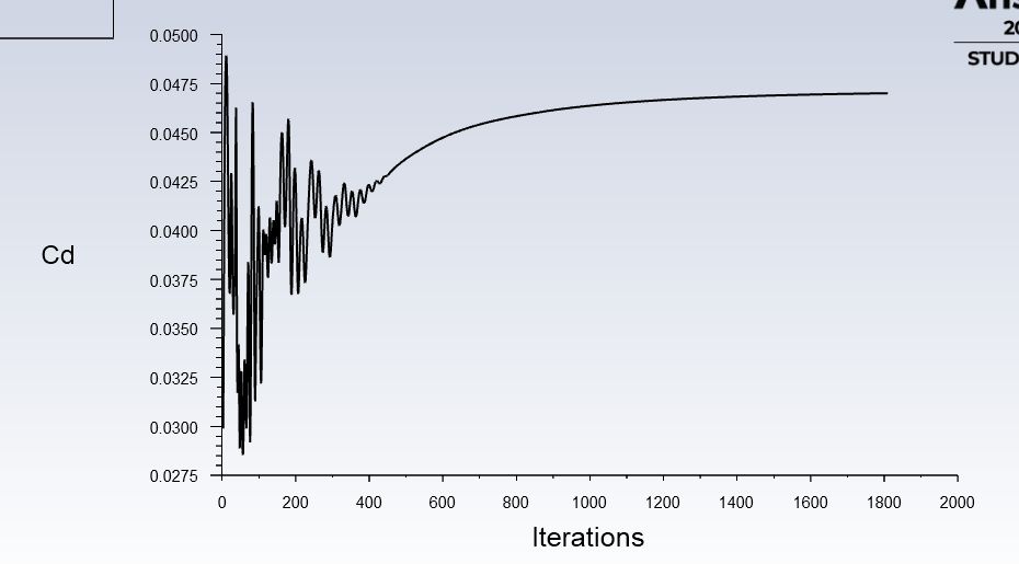

        Cd at 0°:

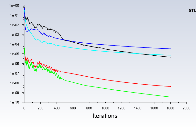

        Contour at 6°:
        Residuals at 6°:
        Cl at 6°:
        Cd at 6°:
        Changed something in the model and now even the values at 0° are wrong.

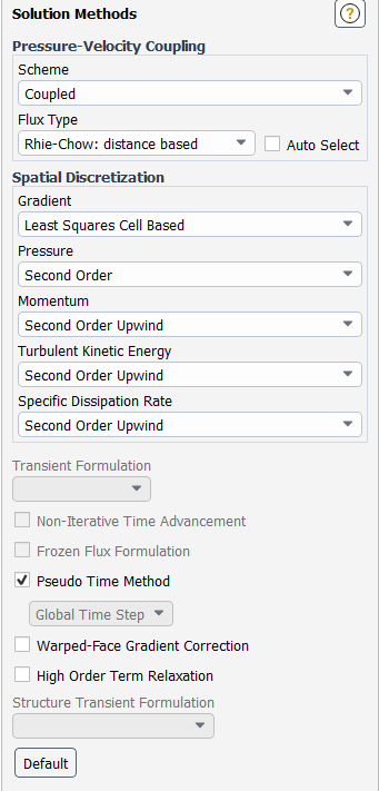

    • SRP
      Can you please uncheck pseudo transient to reduce error and re run simulation once?
      Thank you
      • bianchini.1857628
        Looks about the same even though convergence is slower.
    • SRP
      The issue might be with turbulence model and corresponding y+ use to create the inflation layer.
      When using low-Re models or any models with enhanced wall treatment, the average Y+ value should be on the order of ~1 to ensure we are capturing the laminar sub-layer. When using wall function models, the Y+ value should ideally be above 15 to avoid erroneous modelling in the buffer layer and the laminar sub-layer. High quality numerical results for the boundary layer will only be obtained if the overall resolution of the boundary layer is sufficient.
      I suggest to please check the y+ corresponding to the turbulence model used.
      you can also create an additional variable for the eddy viscosity ratio. Then by plotting this variable , and superimposing mesh in the near-wall region, we can visualize the boundary layer resolution.
      Thank you

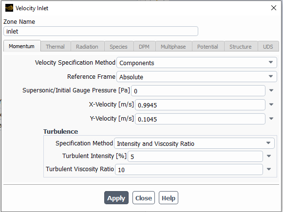

      • bianchini.1857628
        Hi, I figured it out. I changed the walls condition from specified shear stress equal to zero and set it as velocity inlet. Of course I had to change how I defined the velocity, had to use magnitude and direction. Not sure sure what to make of it but results are consistent. Thanks for your help.

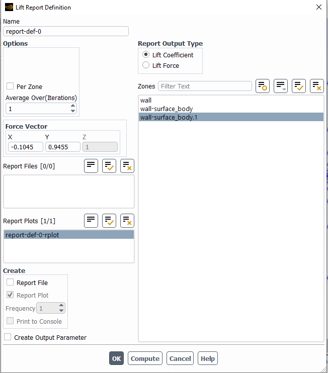

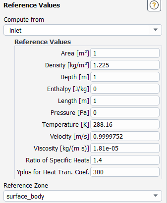

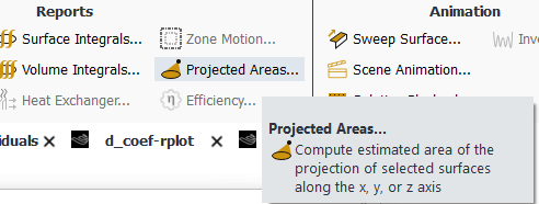

    • ikacar
      The area in the "Reference values" is 1 m2 as default. However, you need to enter "the projection area" coming from Cd or CL formulas. You can easily calculate using the tool below.
