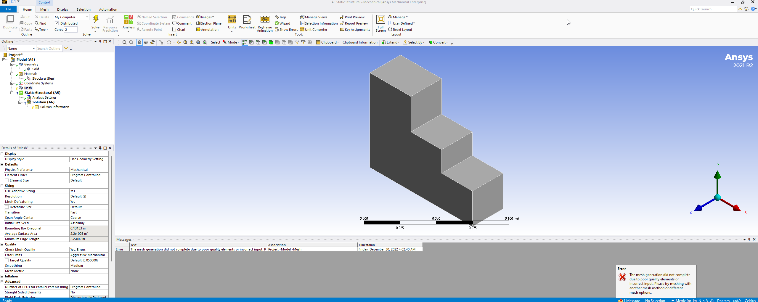

Can’t Generate Mesh – Nothing related with the mesh quality!
    • Burak Kılıç
      Even with the simplest model and simplest settings, I can't generate mesh. This is probably a bug more than a mistake I made. And it's probably related with the system settings in the light of previous suggestions.
      Here is the same problem is about 5 years old and no answers given: /forum/forums/topic/ansys-19-0-will-not-create-mesh/
      There is another which "solves" the problem with changing PC: /forum/forums/topic/cant-mesh-due-to-quality-issues/
      I've re-installed Ansys 2021 R2 almost 10 times and lost 2 full-days. Please help me!

      - ANSYS Meshing failing with an error message: "The mesh generation did not complete due to poor quality elements or incorrect input. Please try meshing with another mesh method or different mesh options". This error message was appearing with each geometry, even with the simplest (cube).

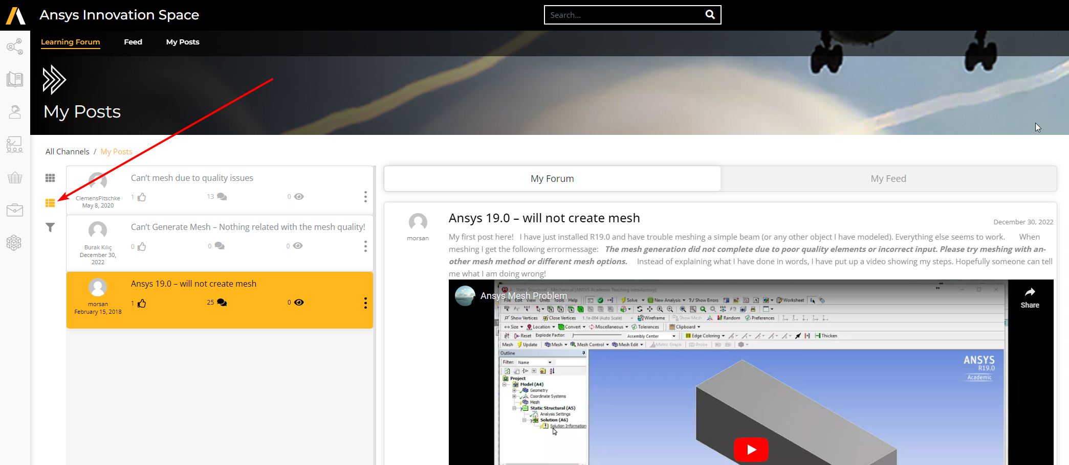

      Here is another bug, this one is from the website:
      1. There is a post of the same issue (5 years old post, so stop blaming 3rd parties and fix it!)
      2. I add my comment to this post.
      3. So, this post can be seen under "My Posts" (In this phase, I wait about a minute to see results, WTF1? This is another bug, Bugception :D)
      4. Then you click that button and can see there are a bunch of comments under the post :D, WTF2?
      While ANSYS is the hardest to install and buggiest software I've ever seen, the ANSYS forum is the slowest and "only" buggy forum I've ever seen in my life. I'm 33, BTW. Please let me know if you "solve" the issue. Thank you :)
