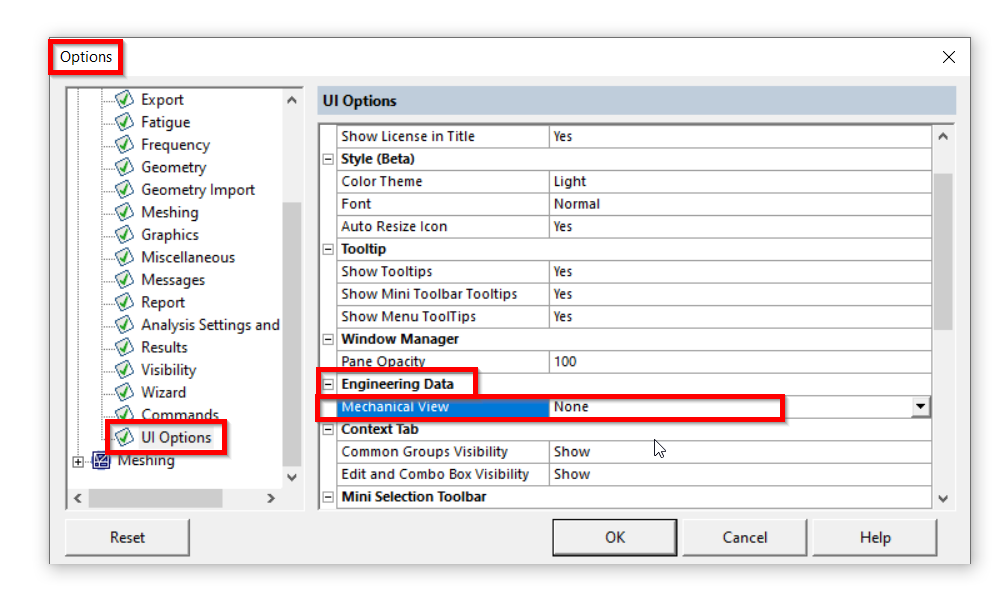

      You might want to try following the mentioned path and try setting the 'Mechanical View'
      option to 'None', to address the situation you're facing.
      Mechanical>File>Options>Mechanical>UI Options>Engineering Data>Mechanical View.
      Hope that helps!
