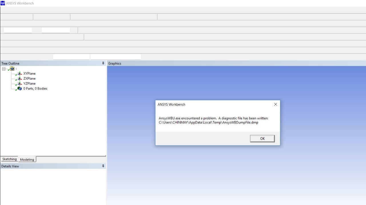

      I am using Ansys student version 2020R2 and unable to open design modeler. I am facing the same error. I've performed clean uninstallation and reinstallation several times. But, it's not working.
      Can anyone suggest me how to fix this problem?
      P.S :- I have used the same version for 1 year and now when I tried to renew the license, this problem arised. So, I don't think it is graphics issue.

      Did you try any of the advice in this discussion, such as deleting ANSYS folders from %appdata% ???
    • ChinmayD
      peteroznewman
      Yes, I did. I have tried every suggestion from this discussion. I have tried clean uninstallation and then reinstallation many times. But, unfortunately it didn't work.
      ChinmayD
      Open a new discussion in the Installation section. Maybe someone from ANSYS will respond.
      I can only suggest the drastic step of formatting the C: drive and making a clean installation of Windows 10 followed by installation of ANSYS Student.

      After you install Windows, download and install the latest version of the graphics adapter driver.
    • ChinmayD
      peteroznewman
      Thank you so much for your valuable suggestion and prompt response. Ansys has started running smoothly after I reinstalled the windows.
