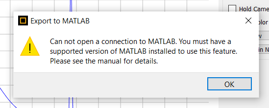

SubscriberAfter I finished my simulation and want to save the data into the matlab, Lumerical cannot open the matlab.
I have already tried to delete the Matlab2021a and install a older version (Matlab 2018b) but it still does not work. How should I solve this problem? I also followed : https://support.lumerical.com/hc/en-us/articles/360026142074 to setup the path but it still does not work.
Could you help me solve this?

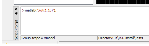

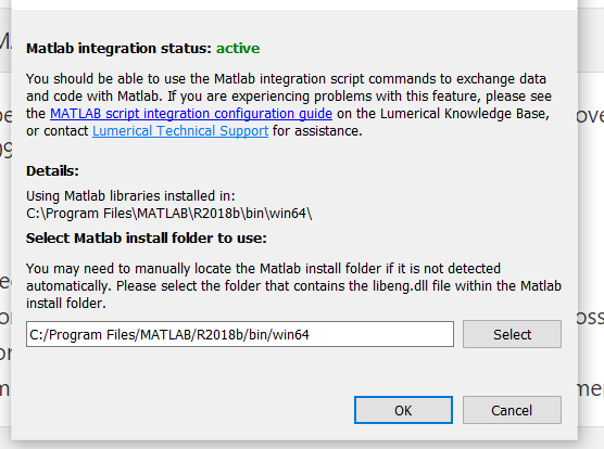

Ansys EmployeeAre you using Windows 10? Try to check your PATH/variables if this has the correct PATH for /MATLAB/R2018b. Run the Matlab registration and check (Step#2) in our KB for the Lumerical to Matlab integration. What is the output of the command from the Lumerical script prompt?
> matlab("plot(1:10)");
September 15, 2021 at 11:01 pmDemingMeng
SubscriberI think it has been solved. The reason is that my folder contains some chinese characteristics.
Thanks a lot for your help!!
