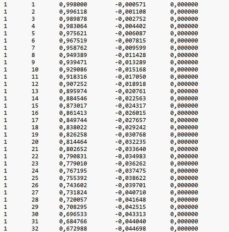

SubscriberHi i have a problem with fluent : in design modeler when i want to import a profile from a file it says " error loading coordinates ". I use the 2020R2 version and the file is openend normally by anyone exept me and i connt figure out why ; I ve tried formatting computer more than 5 times but nothing. I d like to attach the file i need to open here but idk how to do so( i attached an image instead). Anyway its just me who cannot open that file and idk why .I currently use windows 11 but i ve tried with 10 as well and the problem is the same.

Ansys EmployeeI see you are using European decimal separator, which is a comma. This is set in the operating system. Try setting to a dot. Beware of any empty lines also.
https://support.talkdesk.com/hc/en-us/articles/360047099811-CSV-Files-and-Regional-Settings
