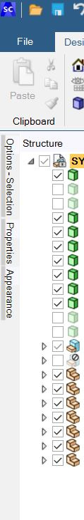

I cannot modify the locked file as shown in the picture below. I could not find a way to unlock. Any suggestion? Thank you!

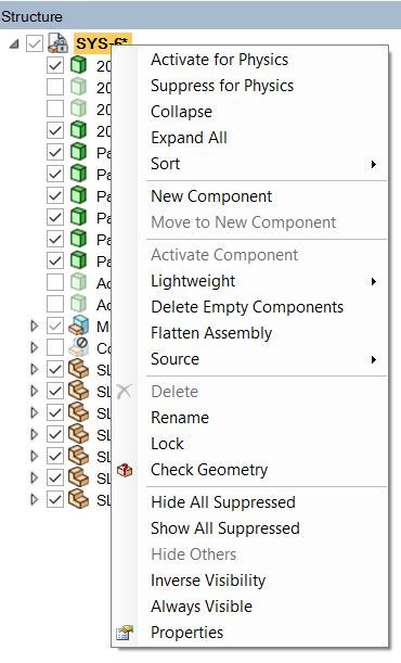

Forum ModeratorRight-click on the locked component in the tree and uncheck lock.n-AniketnHow to access Ansys help linksnGuidelines for Posting on Ansys Learning ForumnJanuary 22, 2021 at 2:14 amJanuary 22, 2021 at 2:51 amAniket Chavan
Forum Moderatorok, so are you saying that you have locked some subcomponents intentionally and see the lock symbol on the root component level (topmost). Can you try copy-pasting all the parts in a new SpaceClaim session?n-AniketnHow to access Ansys help linksnGuidelines for Posting on Ansys Learning ForumnJanuary 22, 2021 at 5:47 amAutonewbie
SubscriberYou are right... Some components are locked for purposes. I can copy and paste to new design file and no such issue...nBut I have to redo everything in mechanical..... is there other way and why is it happening? Thanks!nJanuary 29, 2021 at 1:36 pmAniket Chavan
Forum ModeratorI am not sure why it is happening, but can't exchange files on the forum. And the lock symbol should have gone when you a unchecked the lock at the root level.nTry changing the following option in the properties too:nSys-6> Properties> Document> Locked> Falsen-AniketnHow to access Ansys help linksnGuidelines for Posting on Ansys Learning ForumnViewing 5 reply threads- The topic ‘Cannot Modify Locked Documents – Spaceclaim’ is closed to new replies.
