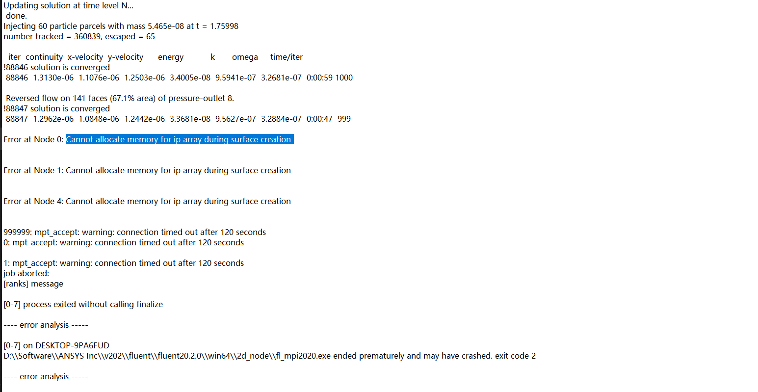

SubscriberFebruary 16, 2022 at 5:40 pmSurya Deb
Ansys EmployeeHello,
Have you tried by injecting lower number of particles?
Also did you try on a different system with more memory?
Also look at the partitions, specially near the injection surface [I believe you are using a surface injection].
Regards SD
February 17, 2022 at 11:17 amcs_zy
SubscriberHello,Sir
"Also look at the partitions, specially near the injection surface [I believe you are using a surface injection]."
Yes ,I am.
But I don't understand the sentence"Also look at the partitions, specially near the injection surface [I believe you are using a surface injection]."
And the number of particles THAT I inject needs to be this high in order to maintain a certain volume concentration.
So,what should I do ,sir.
Thanks.
