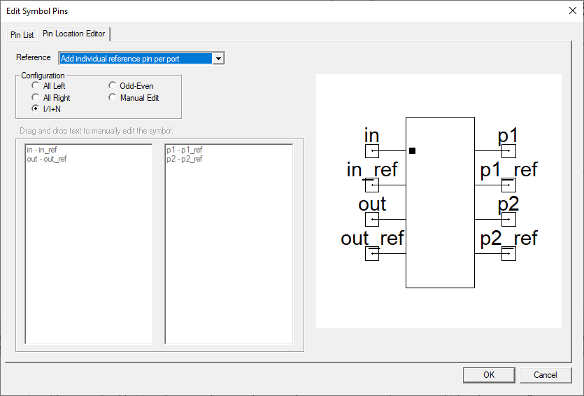

      Hi everyone,
      I need a GND terminal of my HFSS model in the circuit. shall I define a port for the GND of my model in Terminal solution?
      actually I did this ... and I lost all the resonance !

    • Tony Donisi
      Mona4,
      First, there is no "ground only references"  You can show the hidden terminals of the HFSS design in circuit, since an n-port is really a 2*n-port, with the references hidden. To show the references, right-click on the HFSS symbol in teh schematic, and choose  "Edit Symbol-> Pin locations..."  The dialog below will come up and choose "Add individual reference pin per port" in the reference pulldown.
      • mona4
        Hi
        Thank you very much. This is exactly what I have been looking for.
