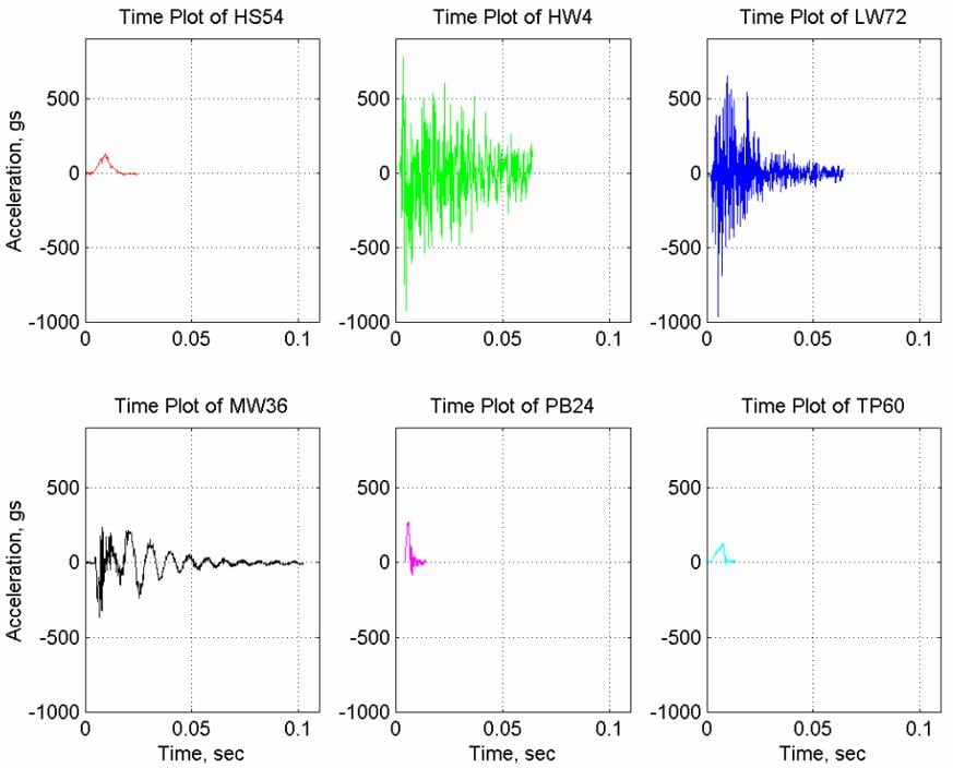

SubscriberOne paper I read about product fragility by Gaberson described how a product was subjected to six different shocks.
Below is the plot of the acceleration vs time plot for each of those different shocks.Â
Many replicates of the product were tested on each of these shocks. A new product used for each single application.
After the application of one shock, the product was tested to see if the shock broke the product.
One of these shocks never broke the product being tested. Five of these shocks always broke the product being tested.
Can you guess which shock did not break the product?
The answer is the blue curve in the top right did not break the product. The other five always broke the product.
The point is that peak acceleration is a very poor measure of the damage a shock can do to a product.
The conclusion is that Pseudo Velocity Shock Response Spectrum is a much better way to evaluate shock severity.
