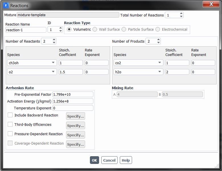

If only pre-exponential factor and activation energy of a reaction are provided, can the reaction and kinetics be used in ANSYS Fluent? If the corresponding temperature exponent and rate exponent are not available and not included in the Fluent, can the simulation provide acceptable results?
Note: I am using species model and volumetric reactions in Fluent
Example:
CH3OH + 1.5 O2 = CO2 + 2 H2O
(pre-exponential coefficient 1.799e+10 and activation energy value of 1.256e+8 (J/kg mole)).
A snapshot of the reactions section of Fluent is attached here.
May 10, 2021 at 3:00 pmRob
Forum ModeratorCheck the maths in the manual to ensure that setting the Temperature Exponent like that doesn't cause divide by zero or multiply by infinity. Given most reactions speed up when things get hot I would question the validity of your assumption.

The rate constant of reaction using the Arrhenius expression is given below (from Fluent manual). Here if the temperature exponent is considered zero the term would be equal to 1. In that case, is it okay to not specify the value if the temperature exponent is not available in the literature for some reaction?
May 11, 2021 at 9:42 amRob
Forum ModeratorIf the value isn't available is that because it's zero or because you haven't found it? If it's the former then that should be OK, if it's the latter your results could be very wrong.
