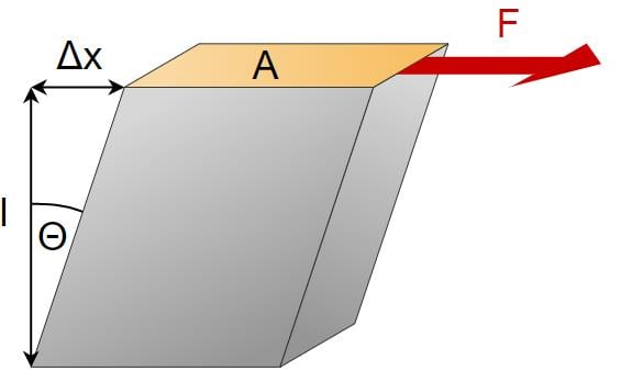

peteroznewman
SubscriberThe definition of shear modulus is given on Wikipedia.
Have you taken a block of material, fixed the bottom, applied a lateral force to the top and measured the lateral displacement of the top? If you do that, you would calculate G from F, l, A and delta x using the formula above.

SubscriberThank you dear Aniket and peteroznewman I kinda figure out this. Using Ansys approach I need to calculate 2 thing for this modulus (right click on "solution">>insert) "Shear" and "Directional deformation" in the co-directional to  load application axes and then just devide it on high of the "my block", and again to devide, am I right?
