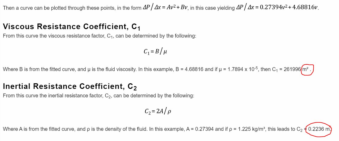

      Was referring to ANSYS Help regarding how to calculate the coefficients (https://ansyshelp.ansys.com/account/secured?returnurl=/Views/Secured/corp/v195/aim_all/AIM/user_manual/aim_boundary_conditions/fluids/topics/c_flu_bc_porous_media_curve_fit.html).
      So we may plot pressure drop against flow velocity in Excel, to get a trendline equation for a second order polynomial fit. Then, calculate the viscous and inertial resistance factors based on the coefficients from the fitted curve, correct?
      With reference to the two circled areas in the attached image, could you please clarify whether:
      1. Should the units for C1 be 261996 [m^-2] instead?
      2. Should C2 be equal to 0.4472 [m^-1] instead?
      Kind regards,
      Jun
    • Naresh Patre
      Hello Jun
      Thank you for bringing this correction to our notice. I have forwarded it to the development team via bug 245772.
