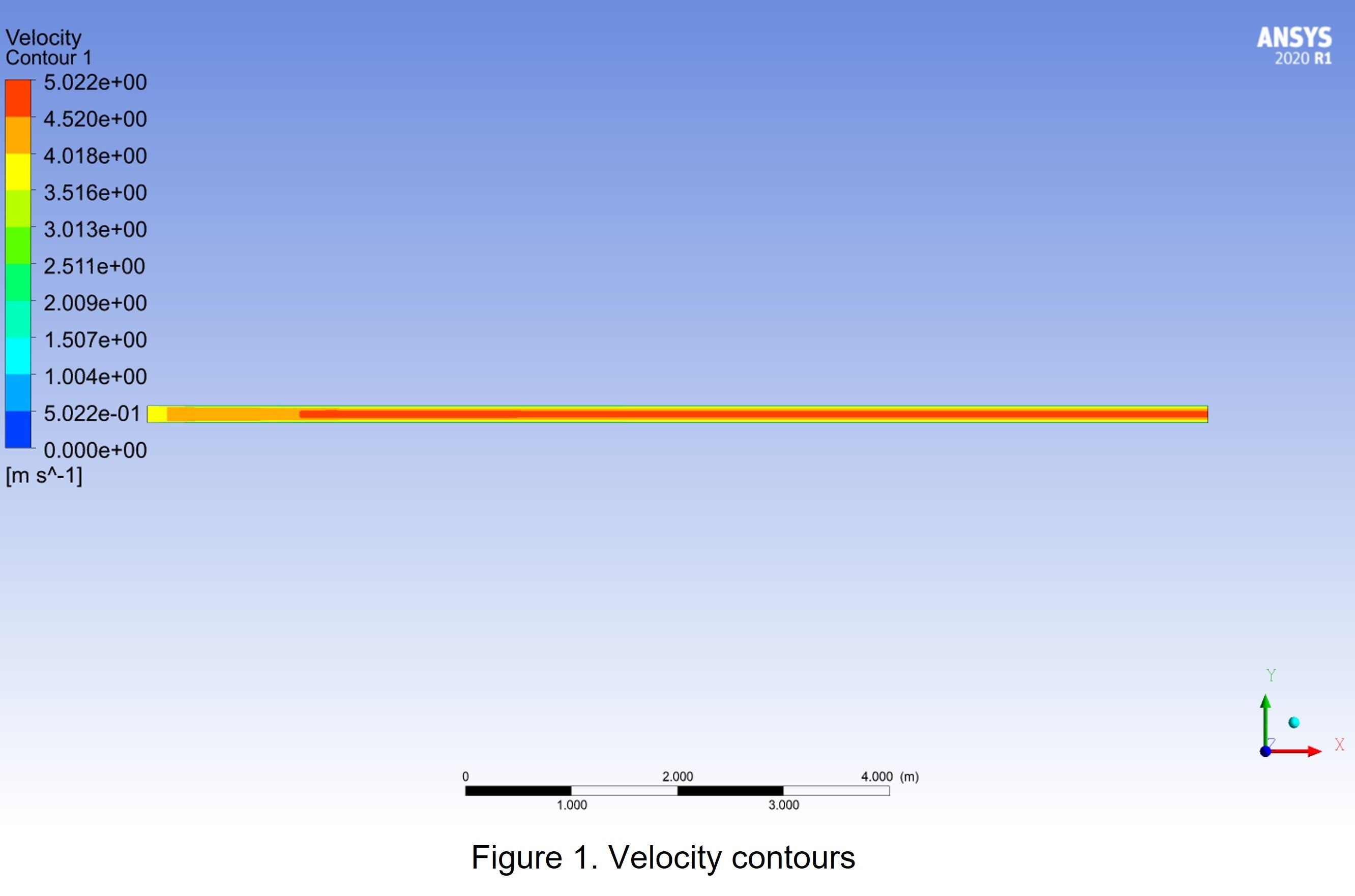

SubscriberSimulating a three-dimensional turbulent flow in a circular pipe whose diameter and length are 0.16 meters and 10 meters respectively. The Reynolds number is in order of 10^5. Here the aim is to find the entrance length for a given pipe.
Models used in fluent: k-epsilon, RNG, and standard wall functions.
Boundary conditions: Inlet --> 0 Pa (gauge pressure), and outlet --> -27.7 Pa.
Wall y+ plus avearge value: between 5 to 10

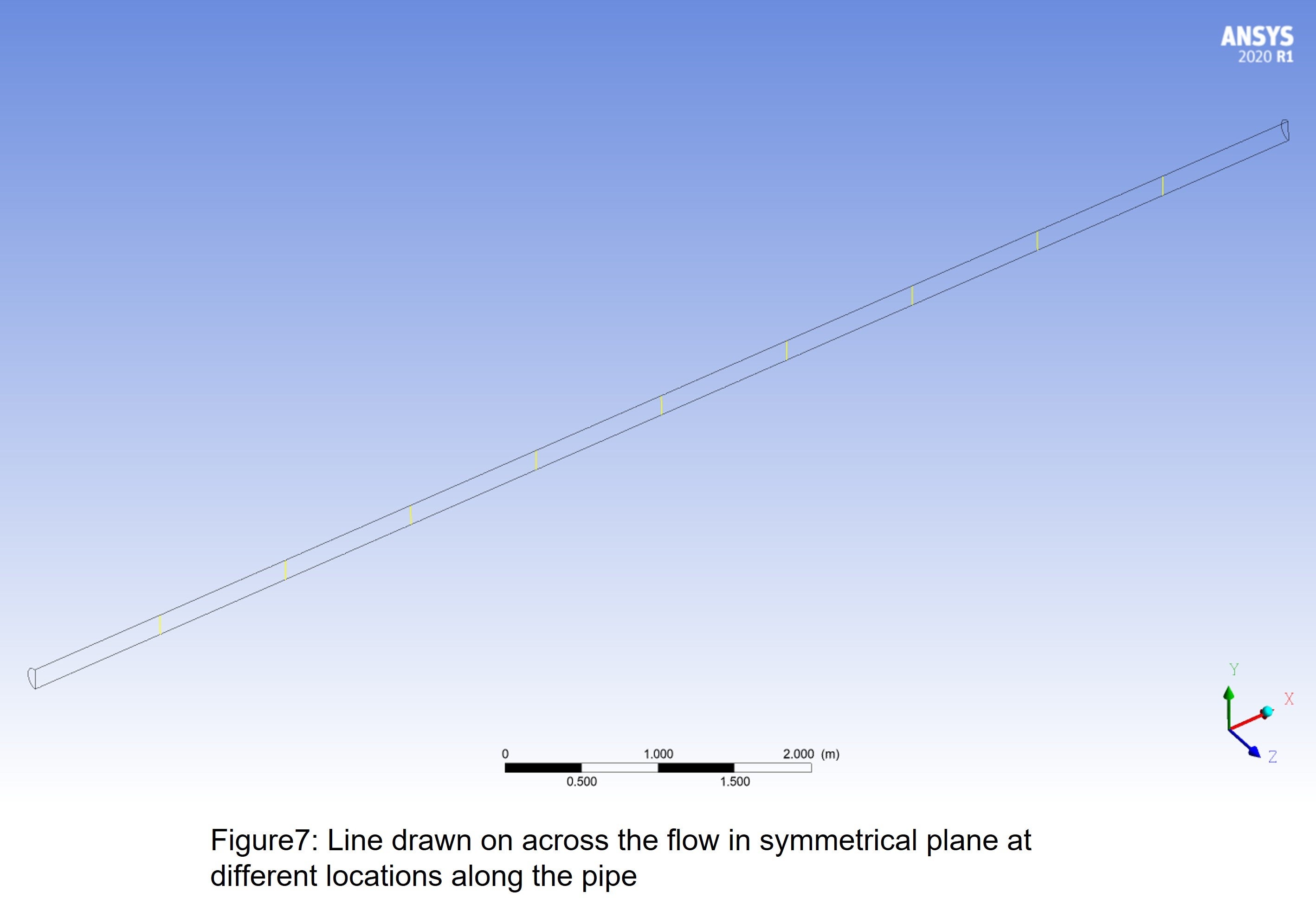

Velocity contours are plotted at the symmetrical plane of the pipe, see figure 1. Velocity across the flow for regular intervals of length from upstream of the pipe is plotted in figure 2. In figure 3, shows the close view of figure 2, shown the maximum velocities regions away from walls.

Entry length (L_el) of above 15 times (say 25 or 100 times) of duct diameter occurs for laminar and transition flows. Entry length of 10 to 15 times of duct diameter is appropriate for higher Reynolds (>=10,000). In my study, I am getting Re=10^5.
Figure 2: The plot for velocity across the flow or pipe at different lengths of pipe.
Figure 3: Same plot of figure 2, just narrowed the velocity (in Y-axis) between 4 to 5 m/s. This is to show how velocity is shooting up and comes back with respect to the length of pipe.

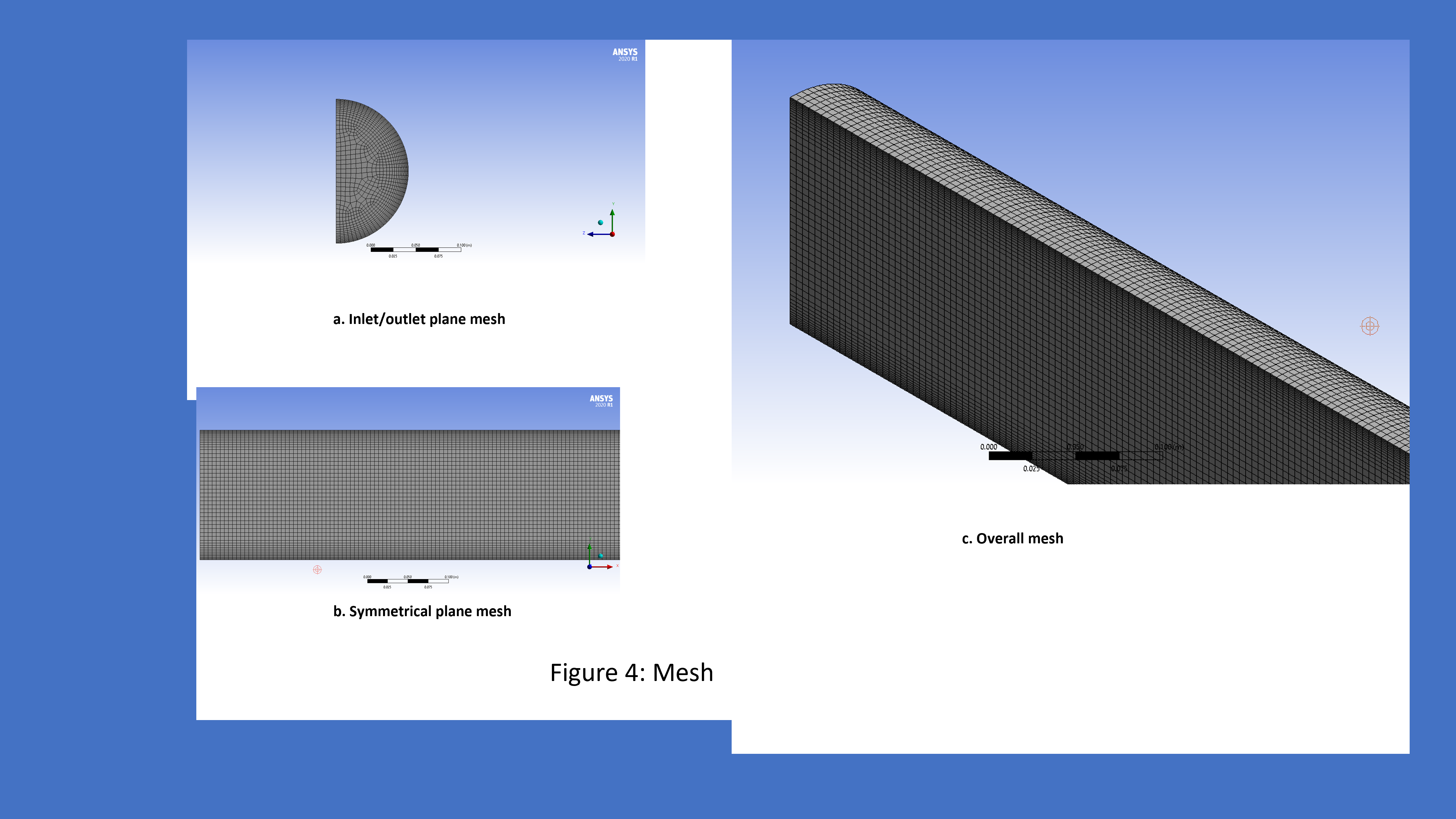

Subscriberand Figure 4 shows the mesh for circular pipe, whose element size is 5mm. Multizone and Inflation are used.

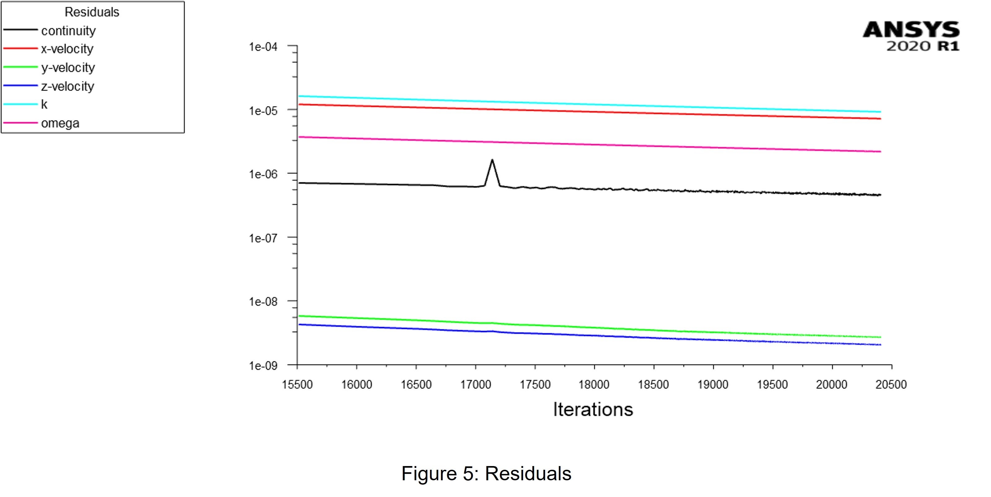

I have tried SST, k-omega model, the corresponding model's residuals are shown in figure 5. There is no significant results difference between SST k-omega and RNG k-epsilon.

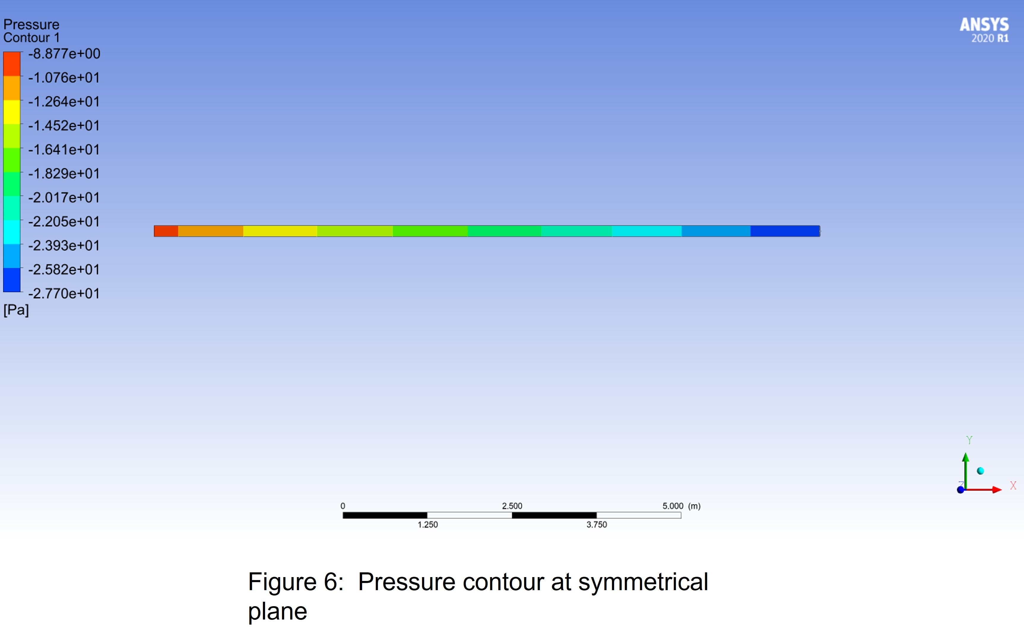

Pressure contours at the symmetrical plane are shown in figure 6.
Velocity contours at the symmetrical plane were already is shown in figure 1, in the first post of this discussion.

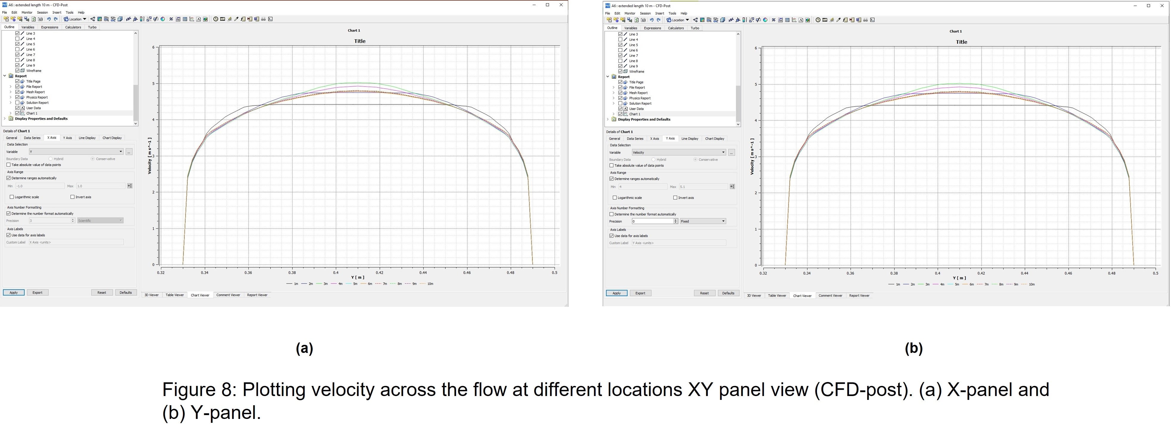

Forum ModeratorMesh looks OK. Can you post a screen grab of the settings you use to get the data for the plots? Ie what EXACTLY are you plotting.

Forum ModeratorOK, please can you post a screen grab of the xy plot panel: I want to see what you're plotting.

Forum ModeratorOK, use the xy plot feature in Fluent and see how the curves compare.
September 14, 2021 at 1:33 pmThirumoorthy
SubscriberYes, both the fluent and CFD post processing are giving the same plots
