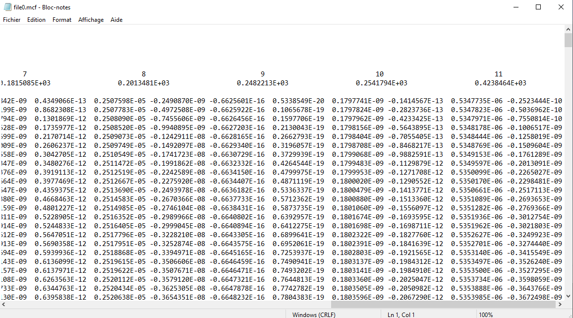

      I performed a modal analysis and exported in a text file X,Y,Z,RX,RY,RZ displacement (in that case, mode shape) of some interesting nodes: here an example
      Line : node (6 nodes here)
      column : mode (10 modes)
      Then, I performed a harmonic analysis with the MSUP method (mode-superposition) linked with the previous modal analysis, and write the MCF file related to it (HROPT,MSUP, , ,YES).

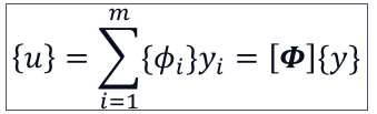

      I know that the idea of the MSUP method is to calculate the displacement like this :
      That is to say, express the displacement vector in the modal basis formed with the mode shapes calculated during the eigenproblem in the previous modal analysis.
      Then, i want to take into account the residual vector, which is the highest modes contribution. When i enable including the residual mode (RESVEC, ON), or the harmonic analysis settings , the MCF file contains one more mode (last column) that is the residual mode :
      In my modal analysis, I only chose the 10 first modes, and the 11th one refers to the residual mode.

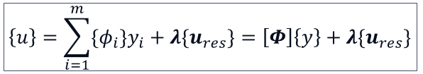

        I know that the residual vector option lets ansys write a last column in the mcf file which correspond to a pseudo-mode (the 11th in my original message). I also know that I have to add it to the displacement calculated by the mode superposition method :
        So the result with residual vector gives me something like this:
        Where {u_res} is the residual vector calculated by ansys in the mcf file (the last column).
        And lambda is the corresponding coordinate (that's something i've found after writting this post). For exemple, in my example, i found empirically that lambda = -0.135 gives me the exact graph i want (the same as ansys), but i don't know how to find that coordinate (somewhere in the rst file ?). If you have any idea, let me know

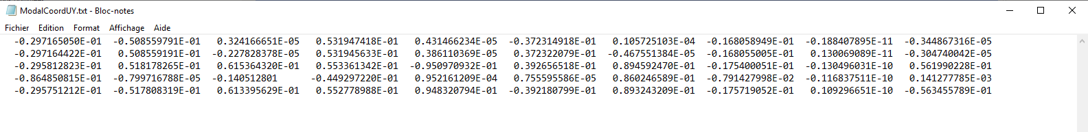

      Update : I think I have found something, for those who were interseting.
      *DMAT, mode, D, IMPORT, RST, file.rst, 11, 11
      *EXPORT, mode, MMF, mode
      This APDL command launched in the harmonic analysis (prior to the ANSYS SOLVE command) allows us to find the mode shape of the residual vector, in addition to the coordinate value of the response at each frequency in the mcf file. It was stored in the RST file after restarting the modal analysis for the RESVEC command (or any other option that requires a modal analysis restart).
