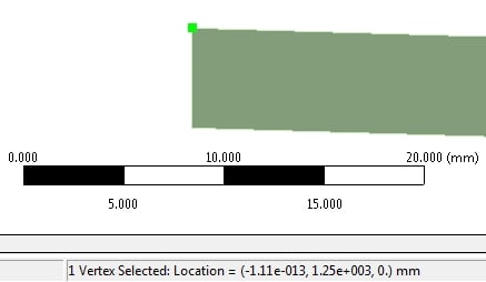

      I tried exporting a 203 STEP file from the #1 SC file, but when I did Replace Geometry in #2 and opened the Model, it would not allow Axisymmetric to be selected under Geometry in Mechanical. The reason is one of the vertices went 1.11e-13 mm over to the -X side of the Y axis, making it invalid geometry for an Axisymmetric model.
      Curiously, this is exactly the same value for the model in #1.

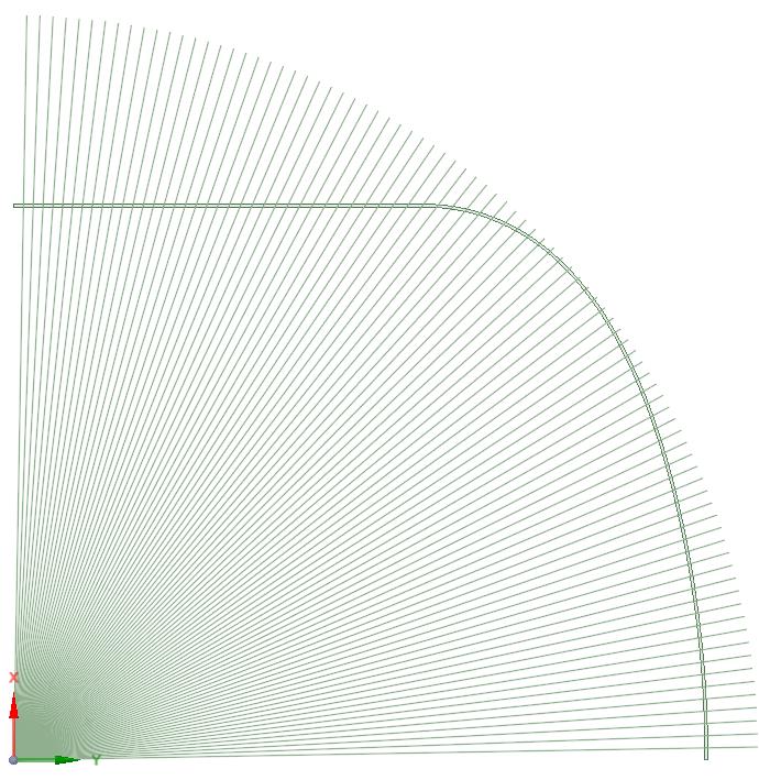

      I came up with a workaround that returns the precision of the exported STEP file found in #2, to the direct SC-to-Mechanical interface, without exporting a STEP file to get that. I have labeled it #5 in the attached archive. It involves creating an array of 88 lines at 1 degree increments that are projected onto the surface. This results in a pressure result of 86.8 MPa, the same result as #2. This is further proof that an insufficient number of points on the spline are being sent to Mechanical from SpaceClaim.
      I hope one of the ANSYS employees will submit this as a defect. Let me know as I can submit this through SimuTech if necessary.

      Dear Peter,
      That basically solves my problem. I will just improve the method of the geometry division with a little script. I really appreciate your time and knowledge, you helped me a lot! I hope Ansys will refer to the problem. Now I can proceed with my research.

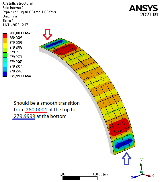

      But there aren't any files attached, so I'm not sure what the solution was exactly, and how I could implement it in my case.
      The STEP export/import does improve the precision indeed. Unfortunately I need the direct SC to Mechanical link, because I'm running 1175 design points with parametrized geometry.
      I'm running a 3D simulation on a quarter of an oval ring, created with an ellipse line in the sketch. So, in my case, an array of 88 surfaces intersecting the part would be the solution? Or maybe create the array of lines before extruding (pulling)?
      Thanks in advance!

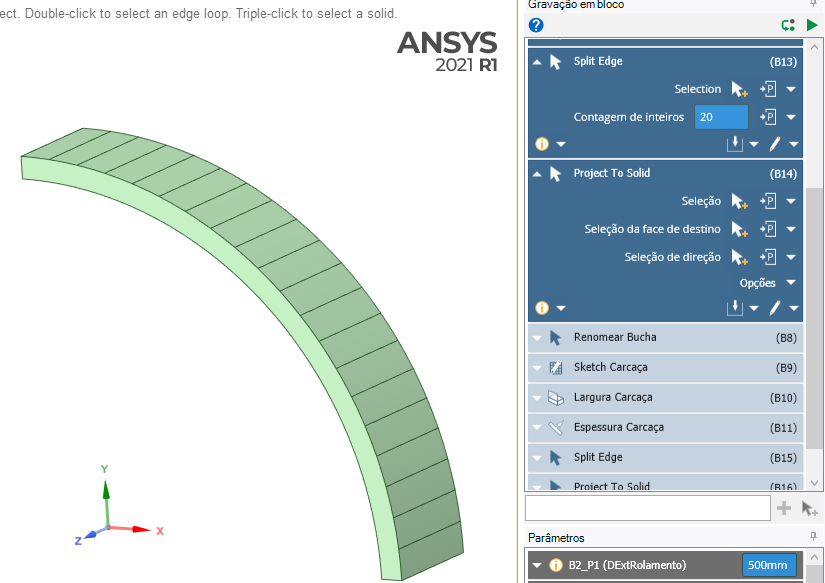

    • Heitor Facuri Cicoti
      I managed to solve it by splitting the external face into 20 faces (even 10 seems to be enough for my case).
      Just use Split, select Split Edge, select the circumference edge, and input the Counter for the number of divisions wanted.
      Then, using Project, select every other split edge and, on Select Target Faces, select the face to be splitted.
