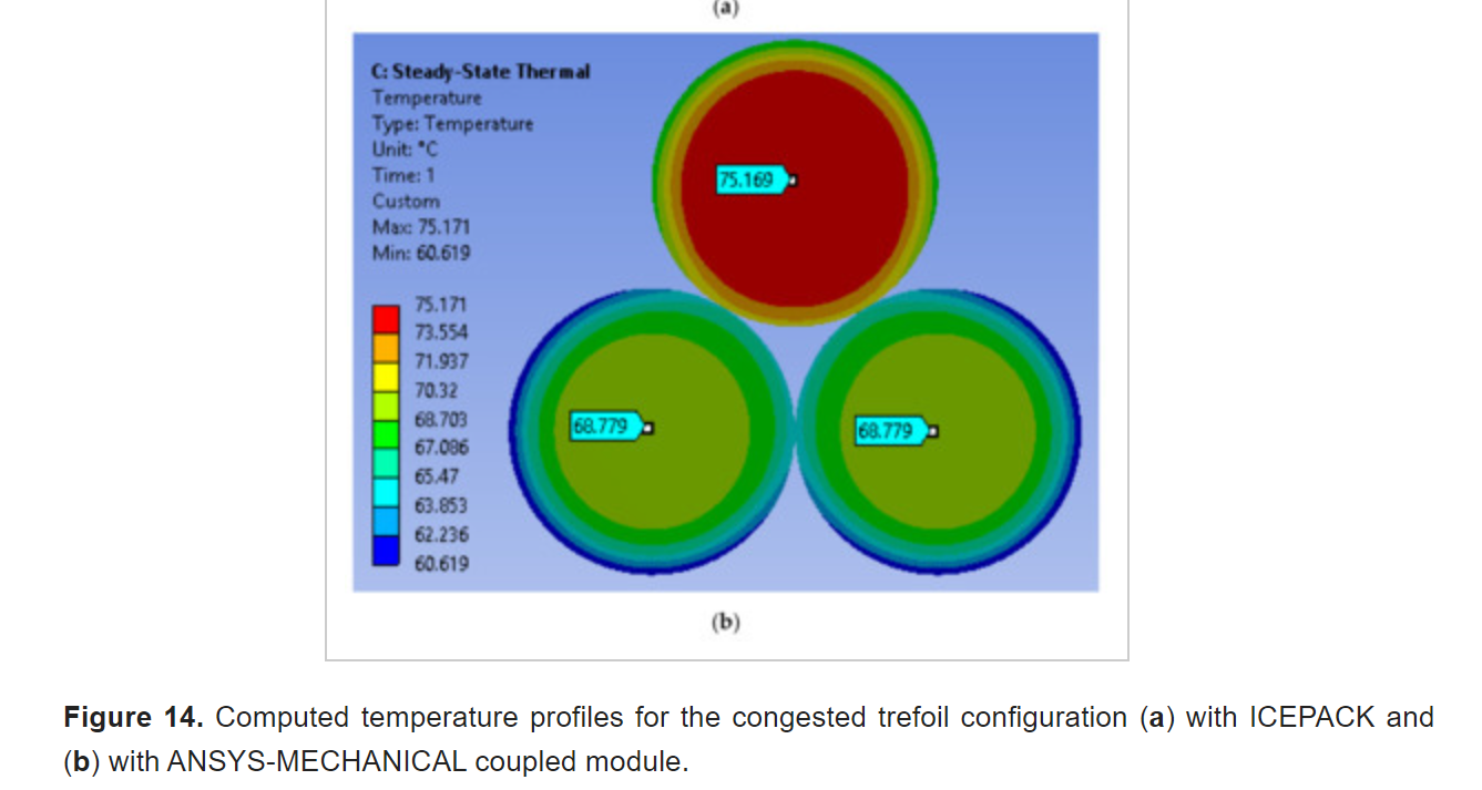

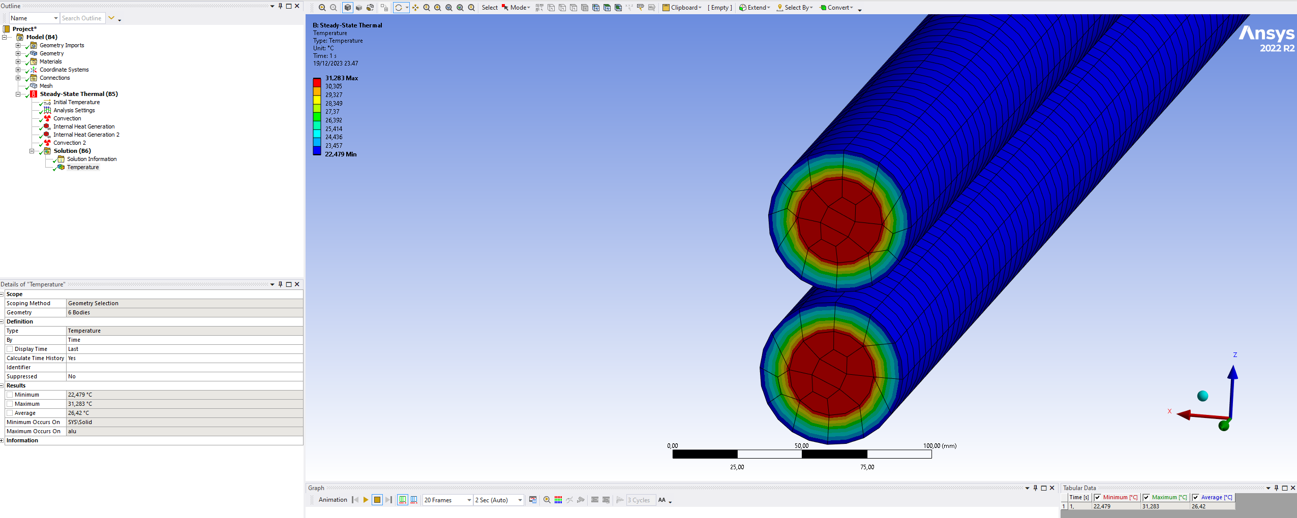

      I found an article that addresses the same issue. How has the heat of adjacent cables been made to affect each other? I tried creating a simple model, but the mutual heat influence between the cables doesn’t seem to transfer. In my opinion, the adjacent surfaces of the cables should be slightly warmer than the outer surface. In the model in the article, gravity also seems to play a role because the lower surface of the cables is the coolest point, due to increased air circulation.
      Here is the article:
      https://www.mdpi.com/1996-1073/14/7/2008
      Here is my model:

      In steady state thermal simulation there should not be any effect of gravity. Also, we do not model fluid in such simulation. You can define convection boundary condition if needed.
      In the paper I thnk the model is solved in Maxwell and then the results are viewed in Mechanical.
